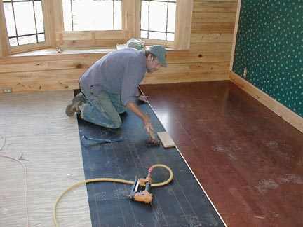

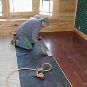

            I think I got a better shot from when I was puttin down the floor..View Image

            Sphere | Feb 15, 2004 04:38am | #10
            IIRC..which I am real bad at..that one was a Bruce a like..walnut veneer on a 8mm staple down core of venners..not solid wood. Here ya can see me with the 8" wide planks and all the tools I had to use <G>..pc. o' cake.

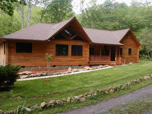

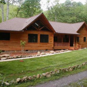

            Sphere | Feb 15, 2004 04:44am | #11
            heres the hose all done..mostly
