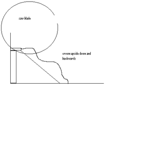

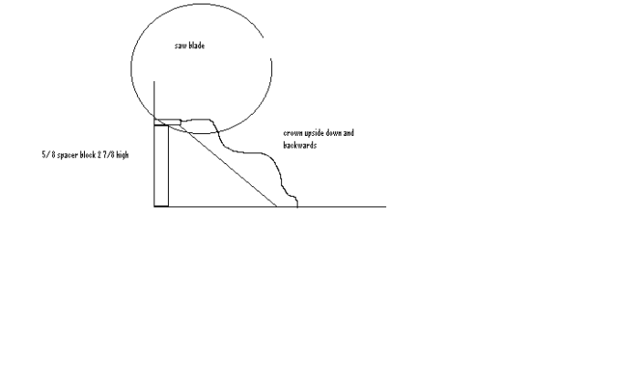

    i then use a 5/8 spacer on the fence of my chopsaw to hold the crown at the correct ht and cut it upside down and backwards, for my crown the correct height is 2 7/8 inches, the idea is to cut the crown at the same "spring angle" as it will be when installed, although the the ht isnt critical as long as pieces are cut at the same ht
    i'll try and draw a sketch of my set up and post it

        1. steve | Aug 10, 2005 02:58pm | #9
          a quick sketch of my setup
          this is a good technique for any trim that doesnt sit flat as long as the saw is big enough, the crown i use can just barely fit under a 10 inch saw, so i use a 12
          nicest thing about this setup is that the bevel stays at o degrees and any tweaking of the cut only requires changing the miter angle
