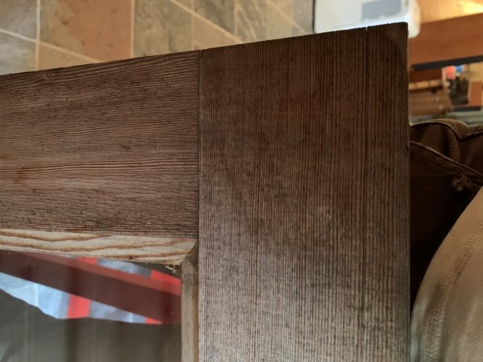

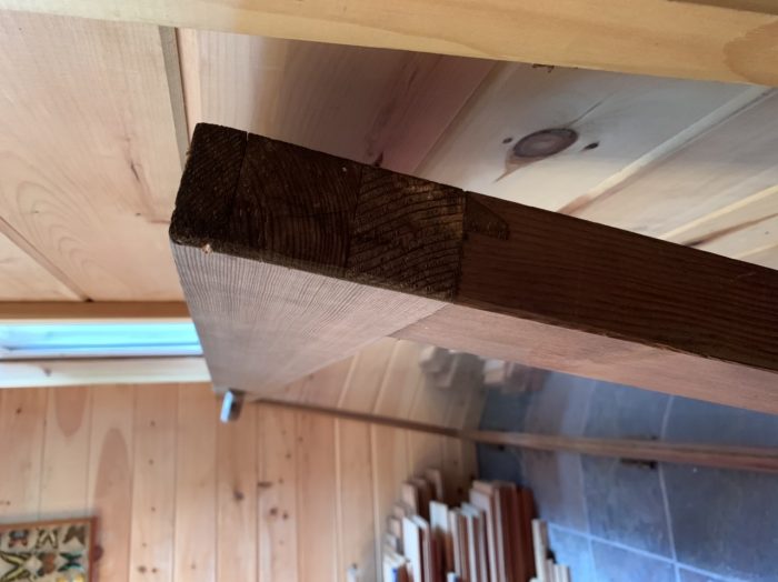

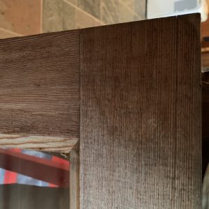

    1. jksymz75 | Sep 17, 2020 03:01pm | #2
      Thanks, oldhand. It is a hinged door.

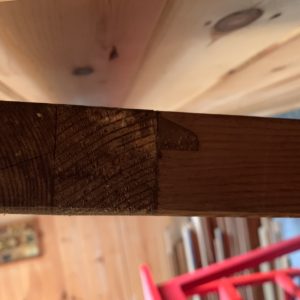

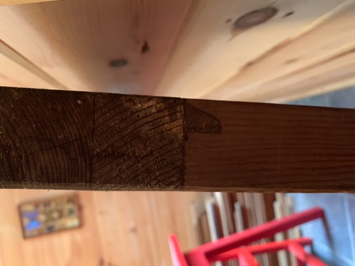

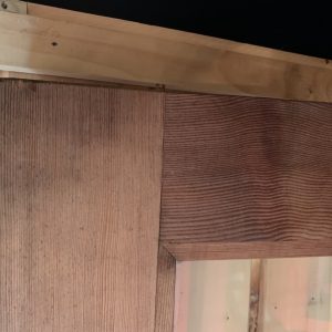

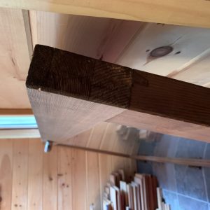

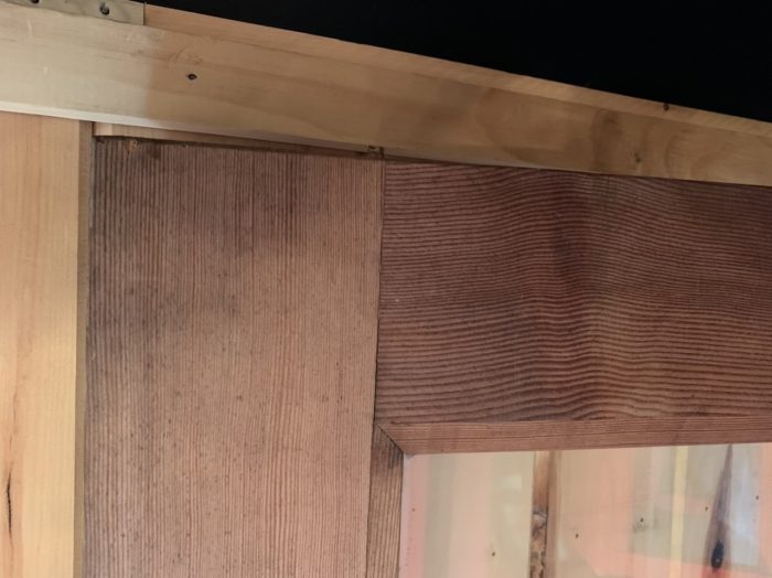

      Here some pictures of the joints. Let me know if there’s more info I can provide to help get better advice.
    sawdust_steve | Sep 18, 2020 07:39am | #3
    That's most likely a mortise and tenon joint which will be almost impossible to recreate. If you cut the joint free and shorten the stile you can use some decent sized dowels to glue it all back together you will probably be fine.
    I would recommend a good marine epoxy glue for a sauna (hot /wet) environment
  3. oldhand | Sep 18, 2020 09:42am | #4
    Wow that's an interesting door, I'd say factory made. Solid core veneered. The photo of the end almost makes it look like cope and stick joint but then not really. Either way my guess is it probably has some large dowels as well. I wouldn't expect it to be mortise and tenon since it's a staved core but it could be.
    It sorta pains me to see such a nice door mutilated but if you do cut it down it might work even without joint reinforcement. I still lean toward the screw reinforcement idea. Inelegant but if properly executed [details like screw type, size, pilot holes etc] might be successful.
    sawdust_steve | Sep 18, 2020 01:56pm | #5
    Oldhand you are right it is cope and stick. I went back and took a closer look and you can see the profile in the second photo. It's still almost impossible to re-create so dowels or screws are the only options
