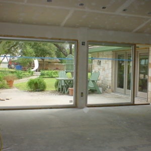

      Here's a pic.  The client wanted a clear view of the ranch...the dining room table will be in front of the glass.
      I didn't really believe him, although he didn't appear to be BS'ing me...I think he was telling what he really thought.  He did explain that the glass was not jammed into the frame, but there was barely enough clearance to get it in...once in it was fine.  And it's warrantied for 5 yrs so hopefully any problems will show before then.

    1. FastEddie1 | Oct 18, 2003 04:02am | #16
      I did absolutely nothing except call them to the site and writte a check.  On things like this, I don't want any involvement in case something happens, so they can't say I gave the wrong dim or whatever.
      Here's a pic...
      Do it right, or do it twice.
