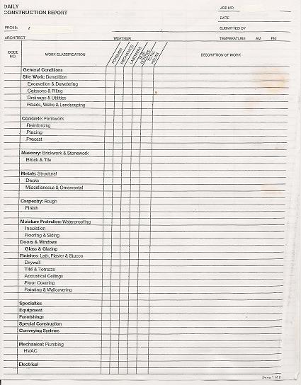

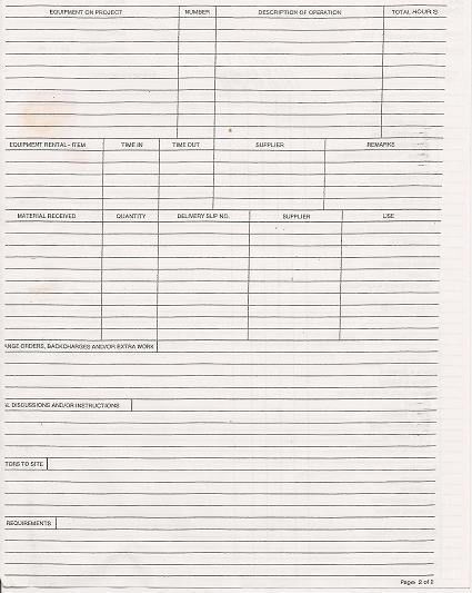

I keep mine in a spiral bound notebook. I was given premade forms and hated them, talked the company into my notebook concept. each day I note start time, weather and what subs show up, major deliveries w/time noted, changes made and important visitors.
Number the lines and make a sentence to report each notable event. I have never had more than 1 page per day and mine have been to arbitration and court as evidence in law suits.
The last company I worked for had all the job super's doing daily reports.
I am attaching a copy of both side of the form.
I use the exact same one for me everyday. I find it very usefull in estimating my next jobs. I also use them when talking with a customer about schedules.
I can do this form in 10 mins and think you could too. I start in in the morning, and finish it while tools are being picked up and job is being cleaned. Same way I did it for the other company
I have been coping the few I had left when I quit. My next goal is to have this be able to be entered in a database and crossed with time cards and estimate spreadsheets I make.
All empoloyees timecards are double checked with what I write on my sheet as well. I know they did that ot other company too, I watched a few get caught stealing a few hours more then once. October 17th, 2009
