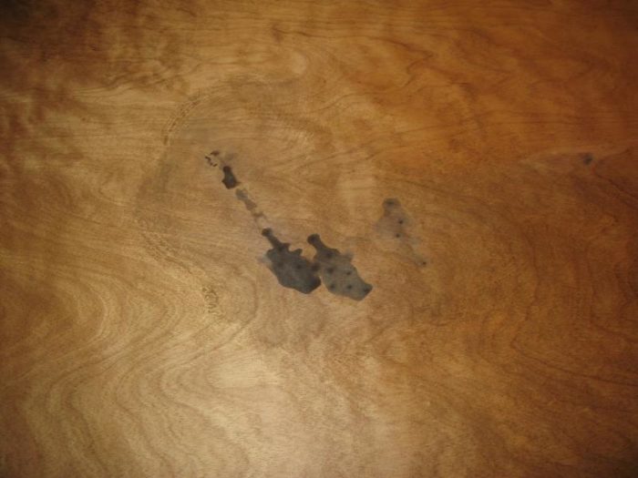

I have a *beautiful* dining table top my husband made to go over our old, small table.   It is made of birch plywood – no seam, gorgeous grain, finished with tung oil.  Over the years, it has given great pleasure for its reflective, honey colored finish.  Sadly, it how has dark stain spots from a leaking, rotting nectarine – don’t ask.  Picture is attached……..
Does anyone know how to remove this stain?  I was going to use steel wool, but knowing the veneer is so thin, I was thinking maybe a chemical remover/bleach of some kind would work.  I’m sick about this and dearly hope someone can help.

        You won't cut through the veneer with steel wool. I would try some toothpaste and a soft cloth first then move up to  Bon Ami with a green scrubby , very softly.
        Feather out the edges if you seem to be removing the patina. Recoat with more Tung.

    You could try "wood bleach"
    You could try "wood bleach" from a paint store.  This is generally oxyalic acid, though sometimes other chemicals are included.
    Birch generally is a fairly non-absorbant wood, so hopefully the stain is not very deep -- some light scrubbing with steel wool may be successful.

    One weak bleach you may have around the house is hydrogen peroxide.  Ask at the Knots first, but you might try applying peroxide (or oxyclean the laundry detergent) on a small area.  Take a papertowel and make 1 inch square about 5 layers thick, soak it with bleach then put it down on the middle of the stain and weigh it down with a flat cup or paperweight.  Come back in 10 minutes and see if you notice any difference.  The moisture also may dissolve some of the stain and come off on the paper.
    If wood does get bleached, one way to get some of the patina back maybe amber shellac.  Apply little at a time with paper towel, wait to dry and see if it is blending in.  If you are satisfied, recoat with oil.  Hope it helps.

    It occurs to me that this is tung oil.  The stain may be simply dissolved in the tung oil.  I don't know what a good solvent for the oil is, but you could use a solvent to remove as much of it as you can and see how much of the stain comes with.  You'll probably want to do this anyway before using wood bleach.

    Oxalic acid will most likely take this stain right out. No muss, no fuss. If it doesn't, there will be no harm to the wood. If it does, there will be no ill effects either except for some raised grain. Then sand and re-oil.
    Oxalic acid comes in the form of a powder or crystal. You can get it at any good full service paint store. Mix only a little (1/4 cup).
