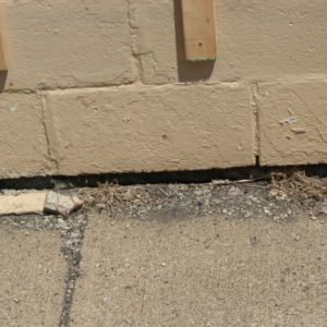

RichBeckman | Posted in Construction Techniques on July 31, 2007 07:25am
The pic shows the bottom of the concrete block on a garage wall.
Yes, the customer understands that it is only a matter of time before the same thing happens again since there isn’t much that can be done to stop the water from coming off the road…
But it still seems like a better idea to fill it than to leave it.
Is there a recommended mix or product to fill this with??
Thanks,
Rich Beckman

    IMERC | Jul 31, 2007 07:33am | #1
    vynal CC patch...
    or
    epoxie CC patch...
    WOW!!! What a Ride!
      RichBeckman | Aug 01, 2007 02:56am | #3
      Vinyl cc patch it is.Thanks!
