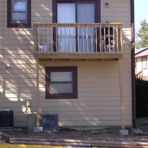

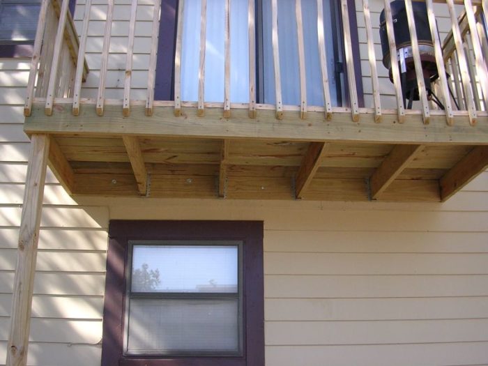

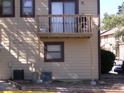

Here’s a real beauty I brought up a while ago in a Hack thread, since I have a new toy, I thought I would post the pictures…Called the building department twice, nobody seems to care.   Talked to the old owner of the complex and the manager, they seem to think this is perfectly safe and I’m nuts.
In the first pic is the overall deck, you can notice that post about 6″+ out of plumb over 9′  and the nice sag in the frame.  The railing orginally had twice the spacing they now have.  After the managers dog about fell through she decided to have the guys add a few more…

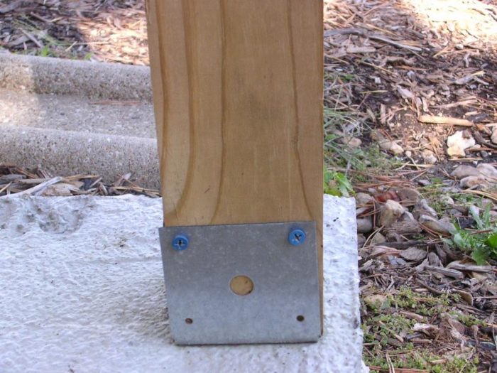

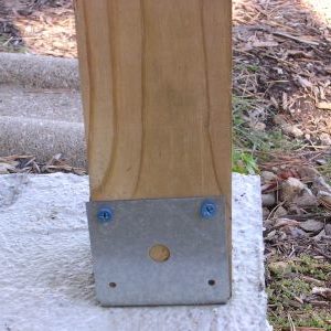

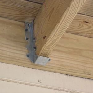

The second pic, you’ll notice the 3 bolts and 2 even have washers!  Oh, and that layout is nothing known to me.
You can learn a new use for tapcons if you wish

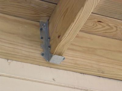

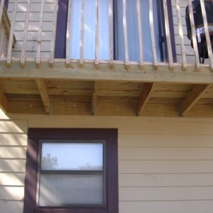

The hangers are screwed in with deck screws and the joists don’t quite sit in any of them.   At least they filled all the holes…

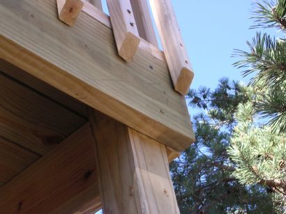

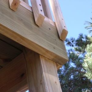

and finally there are no bolts or lags holding the frame to the posts, just 4 screws in each post, 2 on each side.
Really I just wanted to show you guys how good I was!

  1. CAGIV | Oct 18, 2003 02:28am | #1
    I needed some text to post...
    1. dIrishInMe | Oct 18, 2003 02:51am | #5
      It reeks of DIY...
      The fact that the post bases and joist hangers are put on with screws says to me that the person had some intent of doing a good job but overall had no idea of what he/she was doing...Matt
      1. KQRenovation | Oct 21, 2003 06:17am | #28
        That's funny.........when I saw them put in with screws it just told me that the installer does not know how to swing a hammer ;)

        Yeah, this was the thesis of my Worlds Worst Hack job thread, and yeah they are that bad to one degree or another, I just see that one everyday when I park, some are better then that one, as far as I can tell that one is the worst.
        Some actually have plumb post, some have the 3 bolts spread out a bit more evenly, no still not good, but a little better.  None are anything I'd like to stand on with anyone else.

        Well the tapcons are within 6" of concrete, thats something!

    Talk about a hack job, I can't belive the inspector would let that pass. But in regards to the joist hangars, I prefer to use screws myself. But I don't use tapcons or drywall screws!
     I'm a one man show, and I find it easier to line hangars up using screws. (Simpson does make a 1 1/4" screw designed for there hangars), but I use the Deckmate Brand Screws, they have a shear load rating of 105lbs and the Simpson screws are only zinc coated where as these are epoxy coated. I have never had one fail, but I have seen nails pulled loose, and screws have 5 times the holding power of nails. The #9 Deckmates have the same cross section of a 10 penny.
     I'm not gonna argue with you that the deck you have pictured is a piece of garbage, but I don't think using the proper screws for joist hangars compromises the strength or integrity of a deck. However the screws holding the ledger and rim joist! Man that is scary!
    I don't understand! I cut it twice and it's still too short!
    1. dIrishInMe | Oct 23, 2003 03:05pm | #33
      If you look on Simpson's web site I think you will see that those screws are not to be used with PT lumber...
      BTW I really like DeckMate screws too but, sorry, I think using screws on joist hangers is a waste of time... and in applications where a 1.5" fastener is required, I don't think you are gonna find a screw with the required shear strength.
      Personally, I use ledger strips whenever possible.  Faster and cheaper, and by the time I put 8 or so HD nail gun toe-nails in the end of each joist - it ain't coming out!  That, and the support provided by the 3 nails in the ledger strip below each joist...  Face nailing is what makes the whole joist nailing thing suspect, which in a case when I do face nail joists, I always add a few "toes" too.  That, and I've seen some hacks use 8s for toenails :^( .
      Matt
      PS: I've looked at jobs 5 or more years later where I used DeckMates and HD screws, and the DeckMates have better corrosion resistance.
      1. KGambit | Oct 23, 2003 08:40pm | #34
         I like the deckmates too. When I hang the joisthangers, I find it easier to start out with screws. The last 2 jobs I did were t&g Fir on traditional covered porches. And I find that every time I get a batch of 2x' lumber they are never they same. The last 2x8's I ordered varied from 7 1/4" to 7 5/8". This isn't a big deal for 5/4 decking, but for the t&g flooring, I get much better results by hanging each hanger with it's respective joist.
         Working alone I can clamp a hanger on the end of the joist hold it flush to the ledger and drive a screw in to get it exactly flush. The bits hold the deck mate screws very well. I know the screws take longer, but working alone it is easier. Usually I will drive 10 or 12d nails in the holes that go through the joist, but I've used deckmate #9 x3 1/2" which are plenty strong. (And the have the same cross section as a 10d)
         Regardless of which has the greater shear strength, (which is obviously nails). I have never seen a nail or a screw fail when it comes to shear. However I have seen nails loosened and pulled part way out of the ledger, and screws have roughly 5 times the tension strength of nails.
         In the old days they would toenail 2 or 3 10 pennies and that was it! With todays joist hangers you are using 8 or 10 fasteners plus the tabs for each joist! And with the joist hanger, the strength of the hanger is greater than the sum of all the fasteners.
         Everyone uses nails, they are obviously faster, and stronger in shear. I just find it easier to use screws when working alone, and especially when super level/flush joists are needed as for t&g flooring. And although they don't match nails for shear, they are still more than strong enough when combined with joist hangers, and stronger in certain ways.
        (PS How did the Deckmates look after 5yrs? They supposedly guarantee them forever.)I don't understand! I cut it twice and it's still too short!
