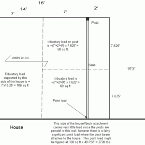

        Matt | Sep 16, 2005 05:20am | #11
        Attached is a quick drawing designed to make you think...
        In the drawing, the load on the post is OK but and footing load is probably quite marginal depending on your soil type.  This load is around 2700 lbs at a 40 PSF design load.  OTOH the beam is definitely over-spanned.  Also, I would hope that the beam connection to the house is pretty strong since it is also carrying roughly 2700 lbs at the 40 PSF design spec.  BTW - 40 PSF is quite minimal.  Some jurisdictions go with 60 PSF.
        If I were building the deck from scratch, I'd probably use 3 posts and not even attach the deck to the side of the house that the joists are parrelel to.  Attaching to that side just gives another area for water intrusion and doesn't support that much weight.
        drawing is attached to next posting
        Edited 9/15/2005 10:25 pm ET by Matt

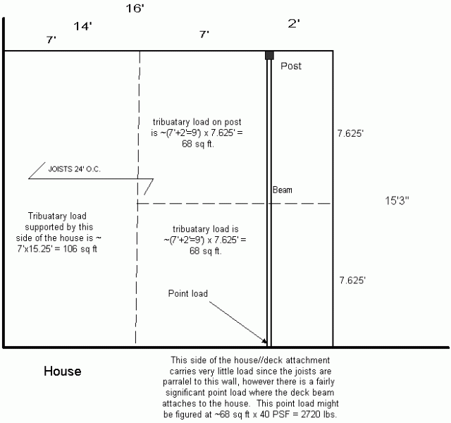

        Matt | Sep 16, 2005 05:26am | #12
        see attached
        1. raftercrafter | Sep 16, 2005 09:16am | #13
          Thanks, Matt. The drawing makes sense and is sort of like the deck I'm talking about. The post is located at least 2' from the end of the beam. I just don't know the rated strength of the 6x10. I'd add another 6x6 post and footing 2' from the other end, shortening the clear span of the beam to 10'-4". Right?
          If the homeowner decides to go ahead, I'll let the plans examiner correct my design.
