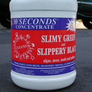

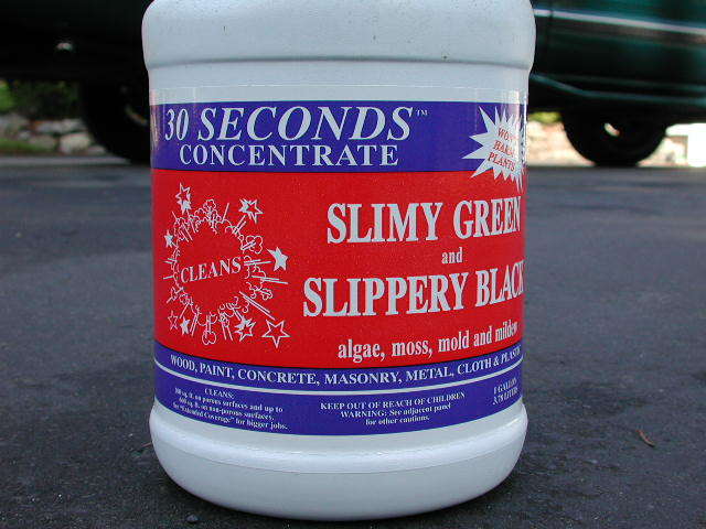

        This is the deck cleaner I use is called "30 seconds" which is endorsed by Ed Hume the gardener because it won't harm plants.
        I like it because it is more powerful than some of the more expensive brands of biowash.
        Lowes carries it for $8.95 a gallon which actually makes 2 gallons.Bob

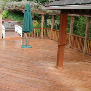

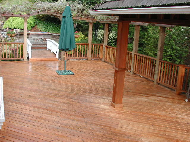

            The "30 second" is a bleaching product and it works great. Here is my clean deck after using the product. I'm just sorry I didn't take the before and after shot.
            The deck was black before I cleaned it.
            Bob
          2. FastEddie1 | Feb 05, 2003 02:24am | #17
            It looks a little shiny...is it wet or did you coat it with something?
            ProDek | Feb 05, 2003 02:58am | #18
            Elcid72- It is wet from cleaning and hosing off the dirt. I wait 2-3 days for it to dry before I apply Superdeck transparent stain with a pump sprayer, then back wipe with terrycloth rags to eliminate any puddling.Bob

    ProDek | Feb 04, 2003 05:00pm | #13
    Oops! I forgot to post the picture of  that deck cleaner. $8.97 per gal
