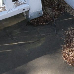

I need to build a deck upon a rolled roofing membrane. It will be a small deck and the roof section is very protected, so I am going to build it on sleepers. The membrane is very soft. Any thoughts as to how I can protect it from abrasions from the sleepers?

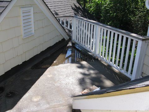

    Spent some time studying the photo.
    That does not look like Roll roofing. Appears to be more of a modified bitumen torchdown which would work if you do a coating to add longevity and make sure it is sound now. or apply another over it of the same, which is necessary anyways to get rid of that puddle.

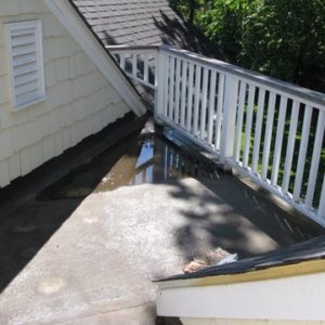

    1. Piffin | Jun 29, 2009 05:38pm | #7
      Yeah, a couple.But I'm about decided this wants a new roof anyways.The guy appears to be a carpenter and not roofer since he is unfamiliar with the materials.The puddled water is a definite negative likely to cause leaks if it is not already.I hate little tight spots like this for roofing - more flashing than roof means more chances for leaks, and snow/ice accumulates in winter to harms things.Add a deck over and you really multiply odds against you.Now, think of this one - suppose there is a minor leak already (making it spongy soft) and the HO just doesn't know it yet.

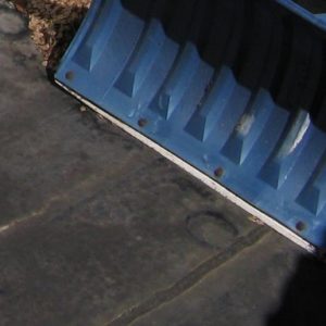

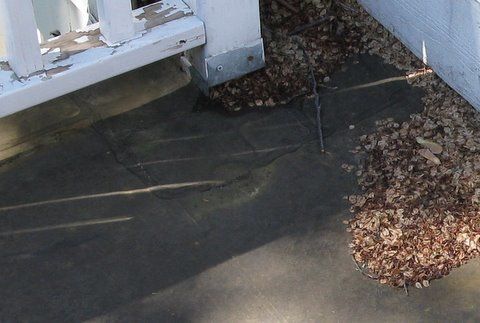

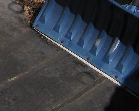

    2. roughcut | Jun 29, 2009 07:41pm | #9
      You are right about where my experience lies - I am no roofer. Here are some close ups. The description of "a tire innertube" is it exactly, not spongy in the substrate though.  Any clues as to what the circle are that are telegraphing thru the membrane? At any rate, the HO won't spring for a new roof, and if pushed will just walk away from the whole project. I will need to do the best I can to protect the existing roofing.
      1. theslateman | Jun 29, 2009 07:43pm | #10
        Plates screwed down to keep the 1/2 " fiberboard in place while the membrane is glued to it .

      2. Piffin | Jun 29, 2009 08:33pm | #11
        The circles are the mechanical fasteners holding the substrate to the sheathing. Reason it is more depressed in some places and circling water is most likely because there is moisture in that substrate that is making it swell up.I see several more small hints this roof has or may have problems now or in the near future.one is that a snow shovel with sharp metal edge has been used up there. Only a broom or plastic shovel should see this roof.There is a lot of debris buildup where tree seed pods are drifted in. snow and ice will accumulate the same way.Be that as it may, if you and the owner want to go ahead and ignore the warning signs that seem to exist from this distance - the normal method is to cut strips of EPDM a couple inches wider than the sleepers, glue them to the bottom of the sleepers with contact cement, and lay them in place. Orient the sleepers so as not to interfere with drainage. I use a few dabs of EPDM caulk to tack them down. Nothing is mechanically fastened.then the decking with SS screws short enough to be sure you are not poking thru.There are several threads and photos on this subject if you care to use the advanced search here on terms like EPDM, IPE`, and Deck
