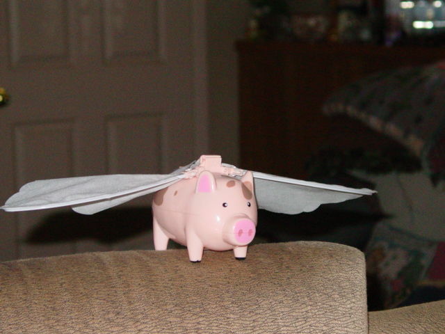

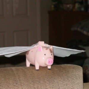

          I'd like to figure out how to work in a pic of a flying pig.

            Ackshally, I have been offered cedar rounds that I will split my own shakes from.
            From Art B. (Junkhound.) Thanks Art.

          3. alias | Jul 31, 2003 02:14am | #16
            perhaps a prototype.....

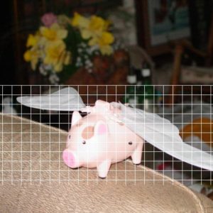

            Luka | Jul 31, 2003 03:46am | #20
            Thank you !
            That second pic may be just what I need to work from.
            I'll try to make a hand drawing, then figure out how I can use your technique to get it to show correctly in the shingles.

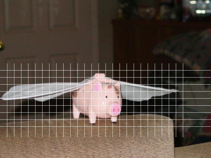

          6. RogerDumas | Jul 31, 2003 03:21pm | #23
            Luka,
            Here you go!  Just make a grid on the wall, transfer the points where the the drawing intersects the grid lines, and then connect the dots with curves that match the drawing.  If you have 5" to the weather you end up with a flying pig that's about 11 feet wide and 3.5 feet high!

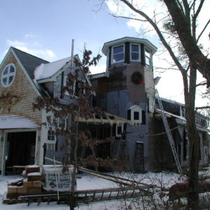

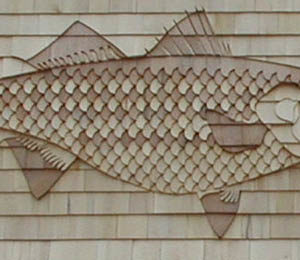

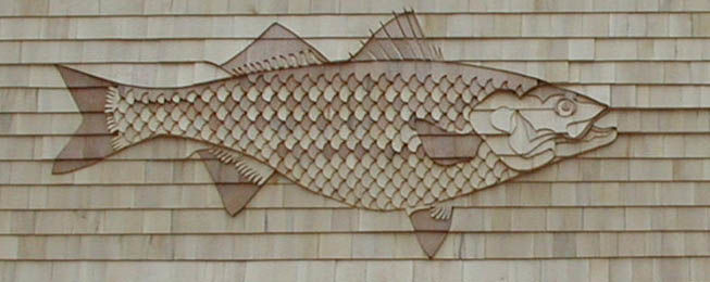

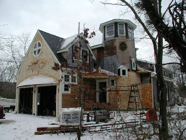

          1. RogerDumas | Jul 30, 2003 08:42pm | #10
            Shake,

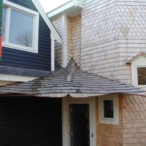

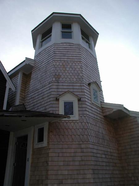

            Here are some pics of my striped bass, whale tail portico, and lighthouse.  I posted these in the photo gallery a couple of years ago.  The fish made a cameo appearance in FHB Jan 2003 in a review of the decorative shingle CD that someone gave the url for.

          2. shake_n_stir | Jul 30, 2003 11:23pm | #11
            RogerD:  You say "your" bass etc.  Does this mean that they are your pictures and or your work?  Are you a contractor of sorts?
            Thanks for the pics!
          3. RogerDumas | Jul 30, 2003 11:42pm | #12
            Shake,

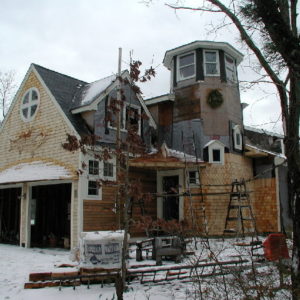

            Yes, they're my pics and work.  I'm a DIY who's been working part time on my addition (in the pictures) for close to 4 years now.  I'm almost finished (finally).  I'm a DIY but I worked for my builder/cabinet-maker father from teh time I was 14 until I was out of school.  And I've kept it up as a hobby for 25+ years.  I plan on trying to start a side business next year doing stuff like that but I don't know if there will be a market or not.  It takes a long time to make something like that so I don't know if people will be willing to pay.  I may try to create a line of smaller (read:  affordable) kits to sell to people.

          4. alias | Jul 31, 2003 12:52am | #13
            roger that was the picture i was talking about that was beautiful could you go through your sub structure of the whale and is the overhang just shingles extended. and how is it weathering after a couple of years?? thank you bear
          5. RogerDumas | Jul 31, 2003 02:01am | #14
            Thanks bear!  I'll have to find my old pics on the structure of the whale tail and overhang but I'll post them.
            It's aging well.  All the shingles have a nice soft gray color.  In fact, when it's dry you can't tell the difference between the red and white cedar shingles.  I'll take some current pictures to contrast with the originals.

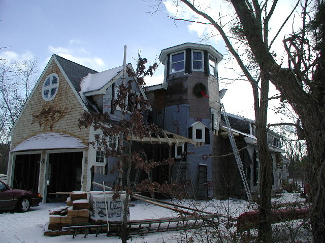

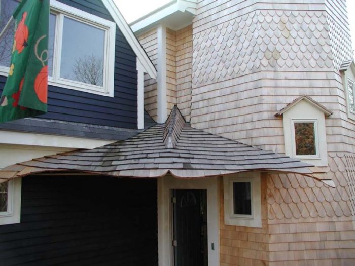

          7. RogerDumas | Jul 31, 2003 02:51pm | #22
            bear,
            I found a couple of pics of the whale tail framing.  Here ya go...
            The first pic shows the beam made of a 2x8 and 2x6 running diagonally across the front.  I think I used 2x8s for the joist.  Even tho they don't look it, the joists were parallel 16 o.c.  They look like they're off because they're different heights where they sit on the beam so that I could get have some curvature on the tail from left to right.  Then I cut the tops of the joist toward the bottom of the portico so that there's some curvature when you look up the tail as well.
            The second picture shows the tail just before the shingles went on.  I ran 1x3 strapping on top of the joists to smoothen out the curves and provide nailing for the shingles.  I made the whale's spine out of plywood.  You can't see it but there are some nailers under the plywood.
            I used a fair amount of lead flashing to make sure the water goes where it's supposed to.  So far so good!

          8. shake_n_stir | Jul 31, 2003 02:26am | #17
            Roger:
            The Bass is very impressive!
