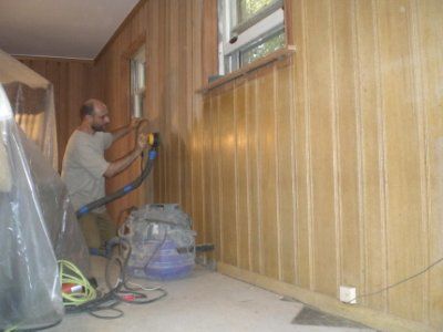

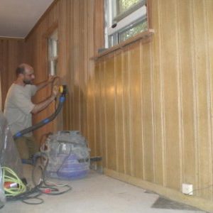

      Ted W. | May 17, 2008 04:21pm | #23
      That's what I sometimes do with my ro sander. Especially when I sanded the finish off all the old mahogony paneling in a 450 sq. ft. basement den, I taped the host to the dust shoot, and the cord to the hose. Taped a multi-plug extension with to the vacuum and plugged both of them into the extension and carried the whole setup around as a single unit. With the 40' extension I didn't even have to switch outlets.
      Now before you say it, I should have used stripper. I know. I thought this would be faster and not as messy. It wasn't as messy but believe me, it wasn't faster. I should have used stripper. Lesson learned!
      Anyway, I didn't think of doing it with my saw while cutting the wall. Would have been a good idea, but it's done now. There will be plenty of next times. --------------------------------------------------------
