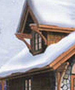

Second, the roof brackets, shown in this pic.  They are elaborate and project way out in the pic, and can be simplified and made more diminutive, not projecting.  There are a total of 11.
In your market, would these details help sell?  If so, what cost would you estimate for each?  What do you lose or gain, if anything, by eliminating them completely?

    I have no experience with the craftsman style brackets, but it seems at first thiought I may be in a $250.00 - $500.00 range per bracket for crafting, installation and finish.
    Have you checked vendors for pre-fab brackets?

    On the projecting brackets, I'd be worried about rot and introducing water back into the eaves. It's a great place for pigeons to roost however.

    What we've found the last couple of years is that things like the brackets make a bigger impact than that jog in the foundation.  We find that paying closer attention to the exterior trim, interior features, interior trim and a decorating theme that harmonizes are the most important features that set us (at least we hope) apart.

    I believe the brackets would add character and help give the structure "curb appeal"  I really do not see anyone except those that knew the original design being able to discern a difference between something shorter and what you have there.  I'd keep them but if cutting the size substantially reduced cost I'd go that route.
     I can see it being a place that receives little regular maintenance coupled with standing snow and constant rain exposure I would find a way to put a pitched top, maybe in copper.  on them to protect them.

    The brackets don't look like much money either.

    Brackets.. probably $330.00 ea. Not counting the extra time to fit shingles around them , flash them etc. All in all a $500.00 detail fo rea one. At least shorten them up the are rot waiting for a time to happen unless you want to spend another $100.00 or so to get each one copper flashed.

        the brackets.... I think if scaled back  could just be "applied" and would keep the look and save on the cost ...

    well, i can see how the notch creates more window space and an alternative view for the sink and i'd be for it; however the braces look wrong. they don't make sense extending out beyond the roof like that. i'd lose those.
