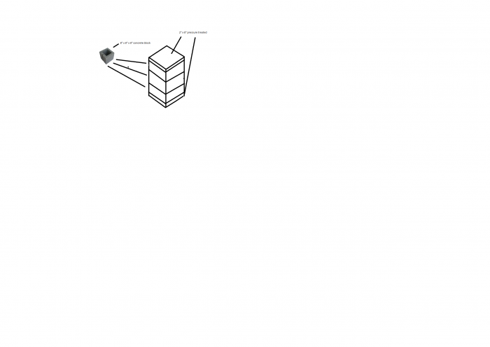

I’m having a pre-built 16′ x 36′ cabin placed on piers (30 per manufacturer’s spec). I’m planning on using (3) 8″ x 8″ x 8″ corner block as piers. My question: do i need to mortar them together, or can i dry stack them? Any help would be welcome. (see attached pic of what I’m thinking)

Pic pretty small. But, what are 2 x 8 treated doing top/bottom? Was the size structure and placement spec’d?
I had planned on using the treated to fasten my underpinning to (not a good idea?). Yes, the manufacturer spec'd the placement and size but not the design.
Best check with inspection as wood “shims” under beams is not permitted. Treated blocks between piers and footings, not a good idea. Mortar up the piers and fine tune with steel or spec’d composite shims as used by iron workers.

How are you planning to anchor the hurricane straps? If they will anchor to your support columns, this impacts the discussion on how to fasten them together.
I would not want treated wood resting on the slab, between it and the columns. I would want masonry to the top of the columns. Seems like good choices would be to mortar them in, or dry stack and coat the sides with surface bonding cement (which still needs the first course mortared in place) You can also fill the cores.
Understand the top treated part. What does the pre-fab cabin expect?
And It seems like a good idea to run whatever you plan past the inspector.
