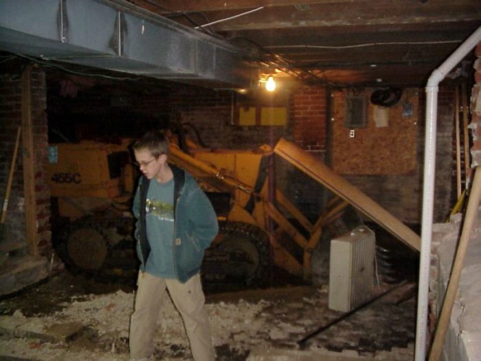

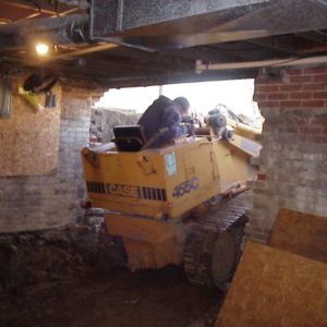

A friend is having their basement dug out. It’s a 90~ year old house with a poor partial basement and 2 different crawl spaces. They hired a contractor for the job.
Since I know both the homeowner and the contractor pretty well, I’ve snuck over and taken a few pics when I got home from work. I’m in no way involved in the project. Just think it’s interesting.

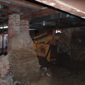

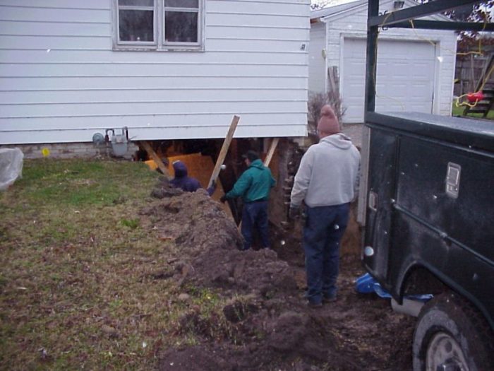

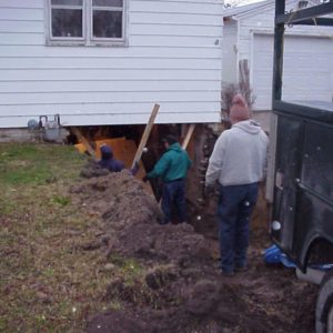

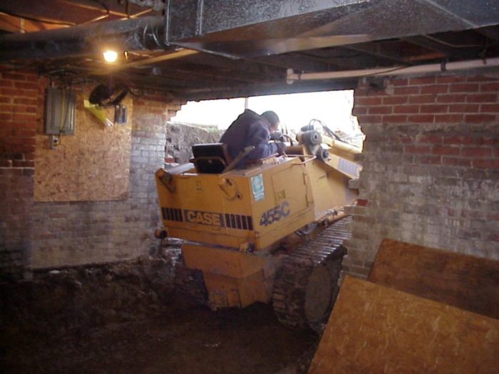

These first 2 pics show the ramp they cut for the dozer to get down into the hole, and the dozer sitting in the basement. They took the roll cage off the dozer so they could get it in there.

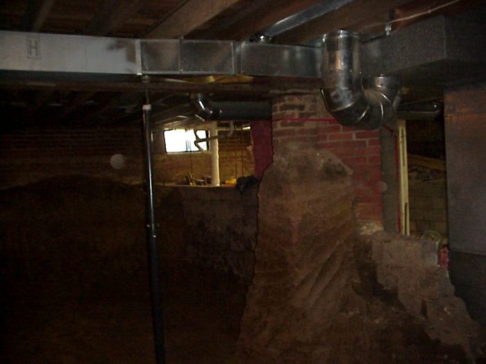

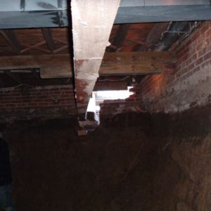

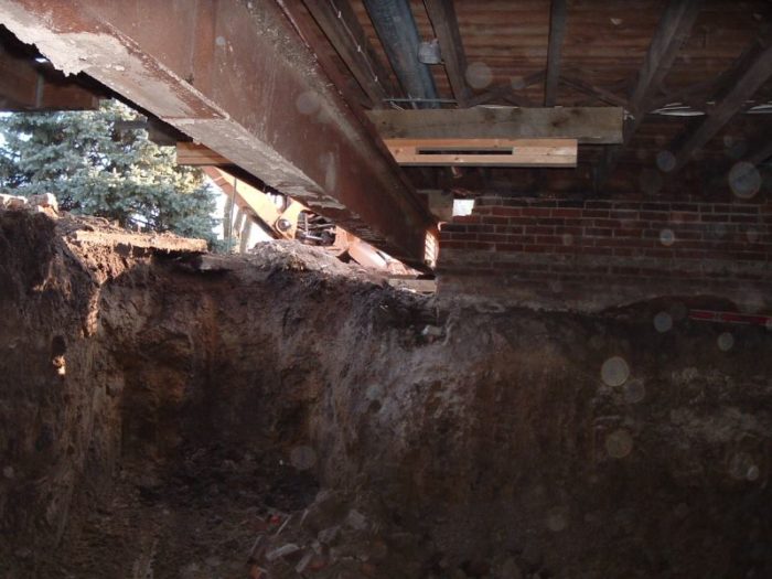

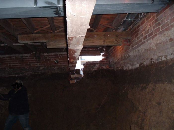

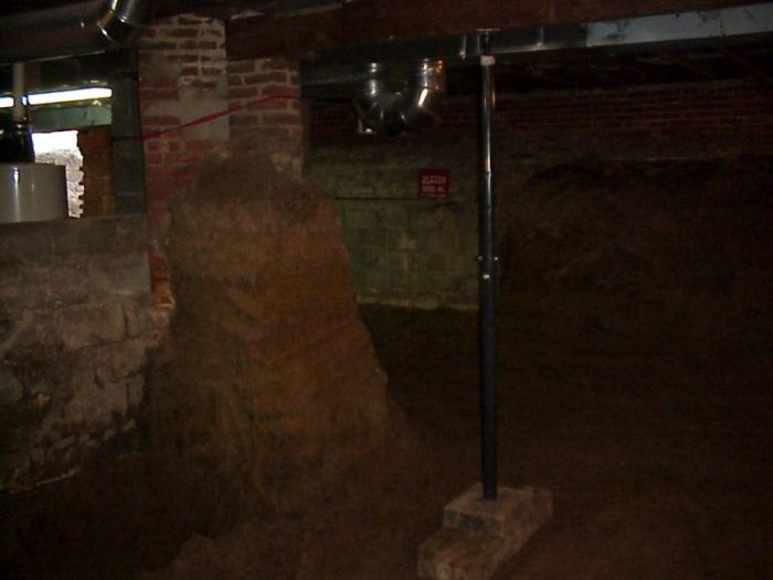

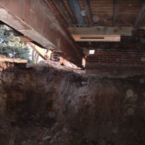

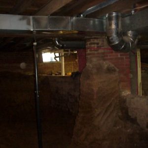

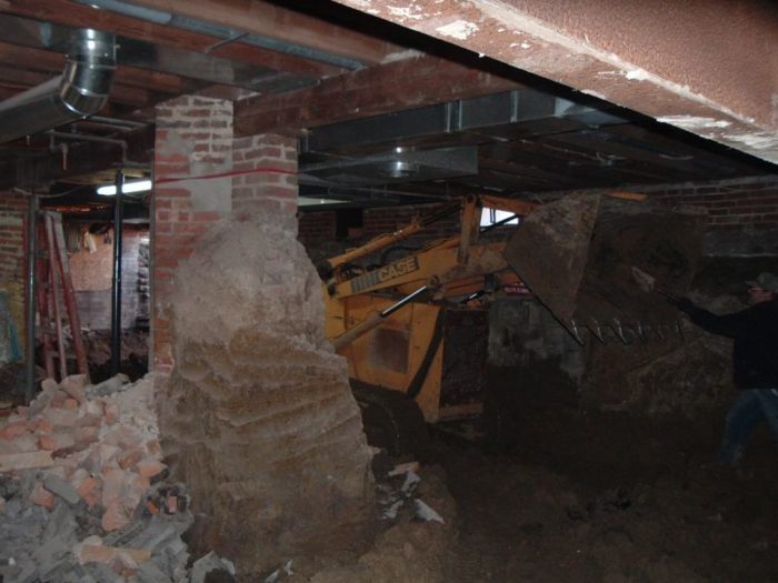

    Day 3 shows a couple of views where they've dug out one of the crawlspaces. You can see where they've left one of the chimneys. I don't think it's used, so I don't know why they don't take it out.

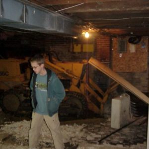

    The last pic is one of the guys backing the dozer down into it's "Garage" for the night.
    That's all the pics I have right now. I'll try to sneak over and take some more if they're still working when I get home tomorrow.

      Ron: re; took the roll cage off the dozer ... OUCH

          JeffBuck | Dec 16, 2003 09:22am | #7
          Bet they left the chimney because even though it isn't being used ...
          it's still there ... thru the rest of the house.
          Heard a story about some people that wanted more room in the basment and first floor ... so they simply dismantled the brick chimney .. in the basement and first floor...
          Coupla days later they heard a loud crash ....
          Guess they finally figure it went somewhere after the first 2 levels?

            Any idea what, if any, precautions were observed near the foundations to make sure they didn't undermine them?
            BossHog | Dec 16, 2003 09:27pm | #13
            "...what, if any, precautions were observed near the foundations to make sure they didn't undermine them?"
            Looks to me like they just tried to stay back from them a ways. I think they're leaving 2' of dirt, then pouring new concrete walls inside the old foundation.I married the first man I ever kissed. When I tell my children that, they just about throw up. [Barbara Bush]
        Patrickjd9 | Dec 16, 2003 07:33am | #4
        My father saw a job in Manhattan in the 1980s where a group of men dug a basement by hand, carrying buckets on their shoulders through an alley walkway for several months.
        The dozer on this job seems like overkill, risking damage for little gain.  Those guys digging the Manhattan basement would probably been thrilled with a Bobcat though.
        1. BungalowJeff | Dec 16, 2003 09:19am | #6
          This kind of work is still done in Manhattan all of the time (cheaper to excavate a store down than move to a bigger space). My Wife's firm gets a lot of these jobs. Sometimes the stone church next door gets upset when the contractor tries to skip the skip sequence under the party walls, but usually the go smoothly....that's not a mistake, it's rustic
          BossHog | Dec 16, 2003 03:48pm | #9
          "The dozer on this job seems like overkill..."
          I don't think so. They have to move a great deal of dirt out. The dozer has a much bigger bucket than a bobcat. And the tracks don't sink in the soft ground as much as the skid steer.
          The skid steer was having trouble getting up the slope in the soft, wet ground. The dozer had no trouble. And the guy running the dozer is talented - I've seen him work with that dozer for many years.There is no accounting for taste, poor or otherwise.
  2. haveasafeday | Dec 16, 2003 07:56am | #5
    How are those "cuts" being done?  Any concern about failue?  Just wondering.

    Anyways, my question to Boss is whether they made any provision for blowing out the exhaust fumes?
      BossHog | Dec 16, 2003 09:28pm | #14
      "Anyways, my question to Boss is whether they made any provision for blowing out the exhaust fumes?"
      On the far side of the basement, there's an outside stairway. They have fans set up in there to keep air moving.To be upset over what you don't have is to waste what you do have.

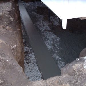

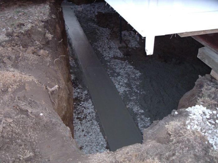

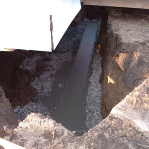

        BossHog | Jan 20, 2004 06:27pm | #18
        I haven't been over there much lately - They've been knocking off before I get home from work and fencing the place off.

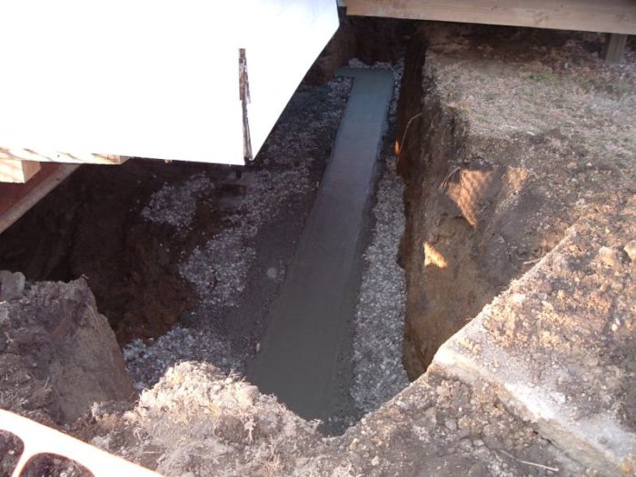

        These shots are of the footings along the east wall.It's time to change the air in your head.

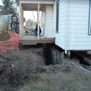

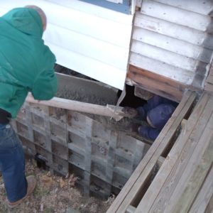

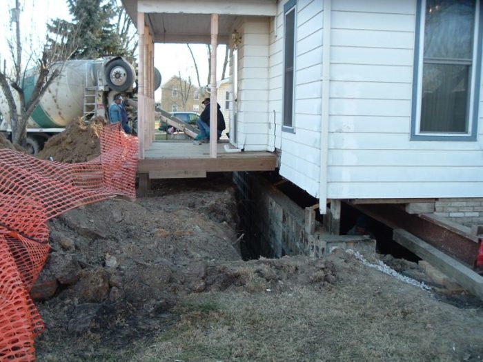

          BossHog | Jan 20, 2004 06:39pm | #19

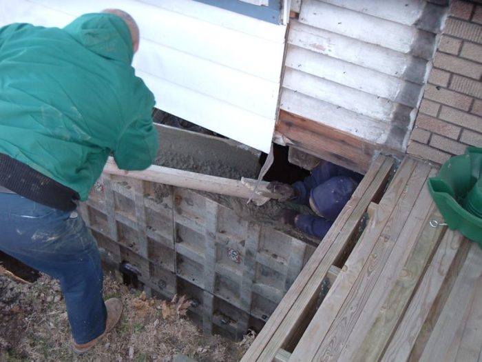

          Here are a couple of shots of them pouring the east wall.
          They're pouring 6' walls, then extending the walls up to the underside of the house with concrete blocks.My tire was thumpingI thought it was flatWhen I looked at the tireI noticed your cat.
          1. rez | Jan 20, 2004 07:35pm | #20
            Hey, in that last pic I see the old asphalt impregnated fiberboard Insul-brick product from the 50s there in the corner.
            I suppose they plan on leaving it on the house? :o)
            BossHog | Jan 20, 2004 07:50pm | #21
            You mean that fake brick siding stuff? Never did know what that was called.
            Actually, I think they plan to eventually tear off the multiple layers of messy siding and replace it with vinyl.Leadership - The ability to hide your panic from others.
        2. user-222107 | Jan 20, 2004 09:41pm | #22
          Great pictures and looks like quite the challenge.  The footings look a bit smooth and usually there is dowel bars sticking up to tie into the stem wall.  Make sure there is good footing drains (don't use black ADS flex pipe-use rigid PVC) set below the top of the footing.  Otherwise water will seep through the smooth cold joint between ftg and stem wall.   Takes a good operator to run a mini excavator under a jacked house.  I'm impressed.
