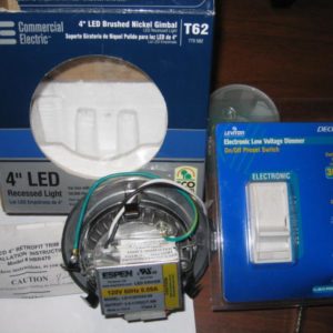

            Here is a pic, COMMERCIAL ELECTRIC LED recessed light model HBR470 -on right top of the box T62 with 770 562.  Levitron dimmer no.6615-pow rated 300w at 120v AC.  The driver is from ESPEN TECH.  called them and couldnt talk to a soul x4, left message-no return calls.  Any thoughts in testing one light with the $20 dimmer I have, or is it possible to damage light/driver trying to dim?
            thanx again for your help
            attached is a pic

            The key is the LED driver. Can you tell me how many input wires this driver has and the colors for the wires. This will tell me if the driver is 0-10V (low voltage dimmer) or if it could work with the standard phase dimmer.
            The Leviton dimmer 6615 is a standard phase control dimmer (120Vac).
            Any additional info on the driver will help. Does it have a label? I went on ESPEN TECH website and couldn’t find any info on the LED drivers. Is it transformer input or electronic driver?

            After all this ha-rang, the engineer from Espen did call 5 min ago and stated it is not dimmable, they will have a dimmable light coming out later this year-the driver is not capable of dimming!?  Thanks to all who put in their efforts.  Will have to decide if this is the application for my room.   This set up is on the lower end side of led lighting I guess.....will keep my eye out for the electrical professional in HD to update him on what he doesnt know.
