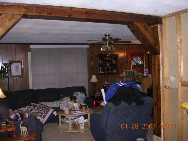

After installing a single door from the screen porch into the existing DR, it was time to remove this “thing” and wall up the space, save for a 3’0″ C.O. and a small pass-thru to the den visible here in the background.

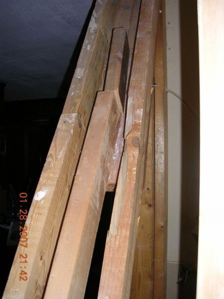

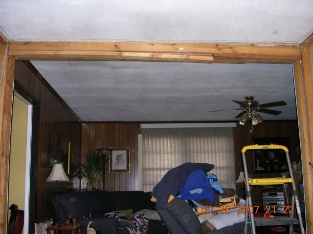

Removing the 1×8 boards was quick work (no sledge-hammer needed), and the absence of a header wasn’t surprising given that I had reworked a similar but smaller opening at the other end of the kitchen. Besides, the double top plate would be adequate to support the minimal weight of ceiling joists, drywall, and R-19.

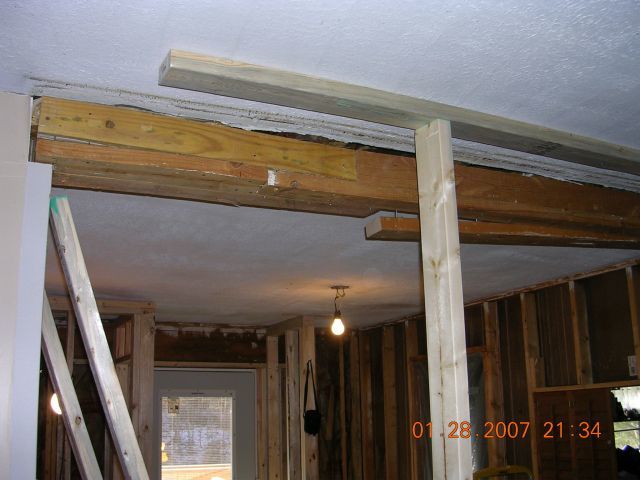

As I began to remove the hodge-podge of 2×4’s, I started hearing some rather discomforting creaks and pops, so for safety’s sake I stuck in a couple of props between single plates.
With the ceiling now supported, I could safely remove the “header” WOW, this shoulda been posted on girlbuilder’s “what’s the worst you’ve seen” thread.

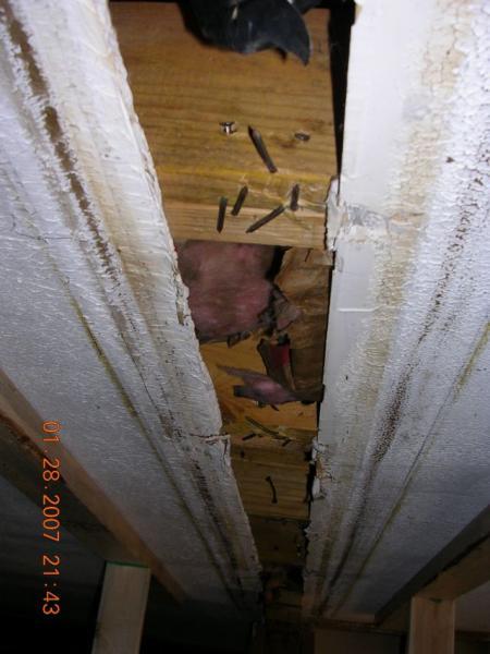

If no header weren’t bad enough, whoever did the previous work had REMOVED THE DOUBLE PLATE FOR THIS BEARING WALL AS WELL. Essentially, the 2 sets of 2×6 ceiling joists were floating in the attic. The 1×8 construction of the false timber arch had been at least somewhat bearing.
Whoever did this didn’t even have the decency to clip or pull the nails that once held this section of wall together.
