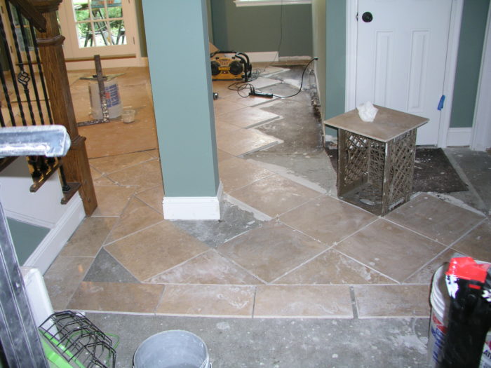

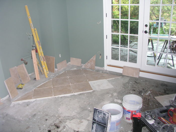

    I just finished doing the same thing. Set 300+sq ft of 16x16" travertine. Just did all my grouting today as a matter of fact.
    I considered Ditra but figured the concrete hadn't had any cracks open in 60 years so why would it now...unless Murphy pops his head up.
    Like Dan said though..putting the Ditra down can't hurt other than setting you back a buncha sheckles and a few hours.
    Just use a real good thinset like Laticrete. Trowel it down with the flat edge of your trowel really really good to fill all voids then comb out a nice even area to set your tile into. I also "always" back-butter my tiles. You should be good to go!
    I need to put together some photos of it 100% done next week.
    Have fun : ))
