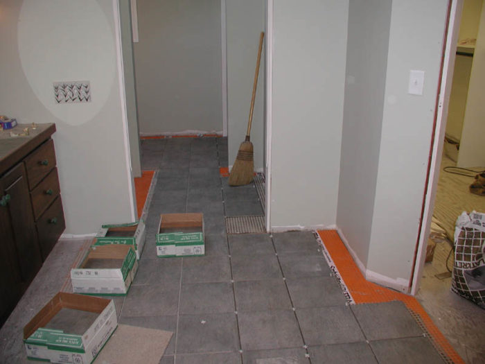

    1. RogerDumas | Jan 21, 2003 01:11am | #10
      I'm using it for the first time based on advice I got here.  It's easy to use and I can see how it'll work to prevent cracks.  It's a nice product.  But, yes, it's expensive.  I'd recommend it to anyone who doesn't mind paying a little more.
      Here's a pic...
