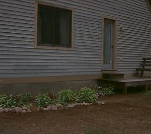

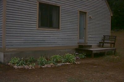

          4. csmart01 | Dec 21, 2002 11:54pm | #23
            As promised (not that anyone was waiting with breath held)
            http://www.home-addition.com/patio.htm
            After all this discussion... I hired the whole thing out. Oh well, I guess we pick and choose our battles.

            Qtrmeg | Dec 22, 2002 05:33pm | #27
            Of course it looks nice, but, why is your house sitting in the dirt?
            I'm not trying to pick on you, that is just not one of the best plans.
          7. csmart01 | Dec 22, 2002 07:34pm | #28
            Qtrmeg: I don't follow about the house sitting in the dirt. What do you mean?
            Qtrmeg | Dec 22, 2002 08:41pm | #29
            Looks like you have a raised bed to the left, against the wall of the house. Sill to dirt height is something I worry about, but if I was of a mind I could get rich repairing the damage that is inevitable from less than optimal situations.
            Yours is far from the worst I have seen, I had had to literally dig dirt away from siding, but it is one of the things I go nuts about. Think about it. Wood on grade is not where you want to be.
            I Do like your project, I look forward to seeing it progress.
          9. csmart01 | Dec 23, 2002 12:20am | #30
            Now I understand. THe dirt is a little loose right now since they back filled with top soil for plantings but still is a couple inches away. The way I see it is if it's not touching it's OK and it's only going to settle more since right now it's loose topsoil they dropped in for plantings. THis picture I have attached shows how it looks. To be honest, they are building all these McMansions around my area where the builders seem to think having 6ft of exposed foundation is attractive. Not me. THe other potrions of my house are 30 years old with this same exact exposure and there is not a sign of rot. All the siding is cedar (both old and new) and the way I see it... 1 inch or 6 feet... if it's no actually touching it's fine (and history on the older portions has shown this to be true)
            Thanks for the kind words.
            C

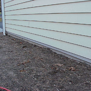

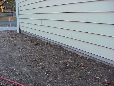

            Qtrmeg | Dec 23, 2002 12:48am | #31
            Ground grows, you can't help it. I am happy so far you have had no problems, but that one spot has roof drainage to deal with.
            I guess this is another case where it would be helpful to include where you live in your profile, that would never fly where I am.
            I'll attach the only thing I have on this comp showing a foundation. Not 6 feet, but close. I hear you about ugly foundations, I have been toying around with granite foundation caps or skins. Frenchy did something like that, I forget how he did it, I remember it seemed like a lot of trouble.
            I'm glad you didn't go off like I was picking on you, if I didn't care I wouldn't have said a word. Btw, 40 years old is nothing, maybe that is where I went wrong.
