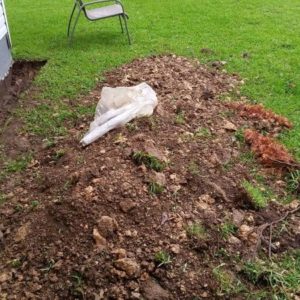

I've seen the stuff from Lowe's that's the corrigated pipeing covered with the fake gravel stuff inside a sock (I attached a photo) and wondered if that was any good. I've looked online and found mixed reviews. I'm also confused on how to drain it out to daylight with way the yard slopes and how deep my trench is (dug to the bottom of the footing). If I bought that stuff from Lowes, should I put some dirt back into the trench first to ensure a good enough slope towards the side yard? Is that stuff any good to use to begin with or should I get the bagged gravel and corrugated piping?
