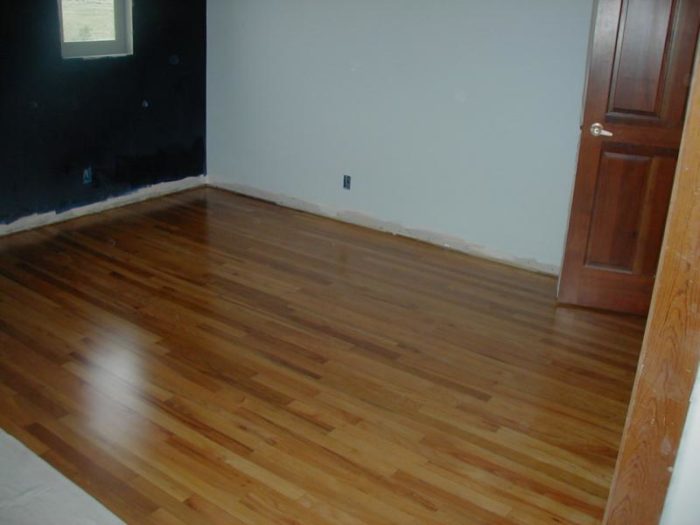

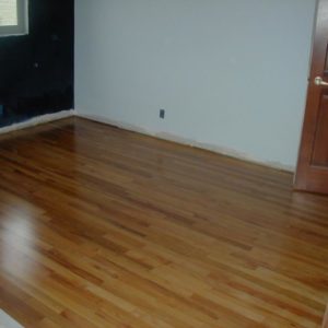

          1. splintergroupie | Feb 25, 2008 07:53am | #34
            My husband had a parquet floor business when he lived in Australia and swore by the roller. When we refinsihed the floors here, it did a fine job with fresh material, but we tried recoating with the material a a couple years later and had the same problem with bubbles. I bought new poly and used a pad, one of those Shur-line green ones. Unfortunately, the poly will dissolve the glue holding the pad on if you leave it overnight so you need a pad for every coat, but a foam pad applicator does the best job on a floor of anything i tried. I'd try a different brand when i recoat next time.
