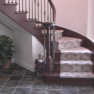

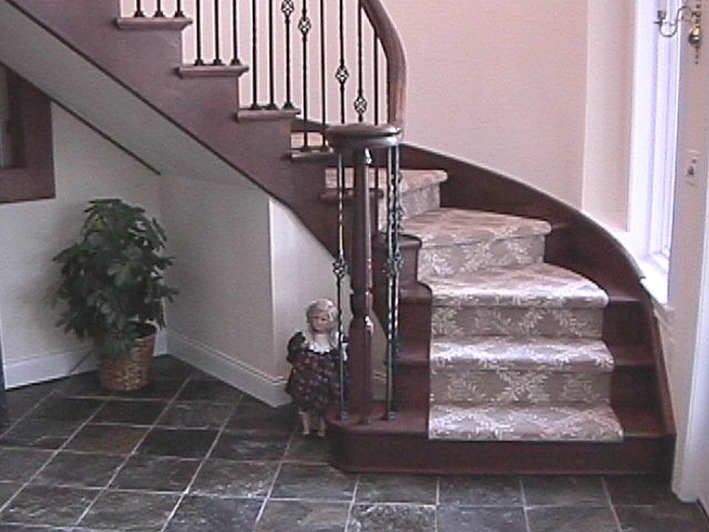

    Mr. Micro:   This stairway that I attached a picture of was one I built two years ago. The inside radius was 11 inches.  The drywaller said he could do it with 1/2 inch drywall....and he did!
    I could not believe it.  He did soak it for awhile and then slowly bent it to the desired radius.
