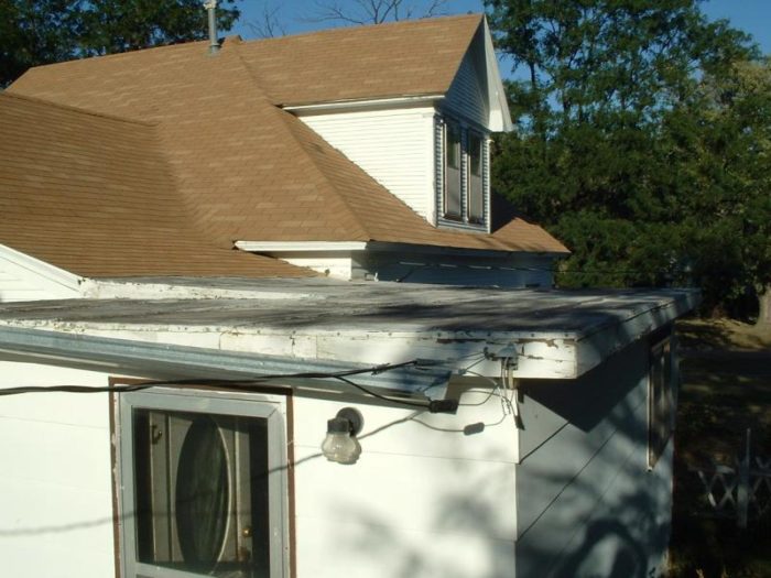

This roof covers a 13 x 22 foot addition to my nearly 100 year old house.  Slope might be as much as 1/4 in 12.  Present roof appears to be maybe 3 foot wide sheets of metal, tarred where they overlap.  I’ve been patching it for a while but would like to fix it for ‘good’, and I hope, add at least some slope.  I found a little information in the archives about tapered foam.  Would appreciate thoughts about whether this would be a good idea, what material to use over it, and how best to deal with areas where this roof meets the old roofs.

    Hw much snow load do you get?  How about just a straight-forward EPDM or PVC membrane.  Shedding water does not require much pitch.

  4. Piffin | Sep 17, 2004 02:52am | #4
    TAB,
    The purpose of ctapered foam for roofiong is to introduce a pitch where none exists, generally on commercial projects with interior drains. Not necessary here on yours at all. You seem to have adequate pitch. 1/4"/12" is a standard requirement for these.
    The biggest problem you have is that flat metal stock never is, was, or will be and acceptable method for roofing an are like this. It has been common in the past to use soldered copper on smaller roofs but an are this size will have too much thermal moverment for those joints and I assume your joints are cualk ond nails. Looks like an ameture solution to me.
    The only question is how much you want to spend and whether you want to do it yourself.
    There are products (Polyglass is one available her) t6hat are a peel and stick membrane with a surface similar to that on the shingles. The adhesive quality is like the ice and water shield products and there is a woven re-inforcing mat contained within the membrane. The rolls are about 39" wide - metric sizing.
    The better product is EPDM rubber roofing, but it is a bit more technical in metjhod of installation and flashings. Carlisle sells to homeowners.
    Regarless of the surfacing membrane, I would definitely recommend that you rework the edge trim on that addition. you need a 1x2 drip strip of wood over the facia and a metal trim designed to shed water out away from the face. As it is, the water is dribbling down over the facia and destroying it.
    Also - be VERY careful around that service entrance and gutter there. It is hard to imagine that this is a safe situation and I wonder how well that drip loop works on that entrance.

    Well Tab, you certainly have a tough area to deal with. Presently you look like you have a dish in that flat roof. Going on the basis of looks, I think I would run a shed roof. You have a bit of a shed roof now where it meets with the flat roofing. I'm guessing you could run rafters from the outside of the addition so that they just come even with the crown molding on the fascia and continue until you intersect the shingled roof. It looks as if you will be going up almost parallel with the short section of shingled shed roof. Where the roof juts out passed the door you could do a standard gable from the mid point of the addition up to the shed rafters. I don't know if you will be able to get enough pitch on that backside for shingles but you can use double coverage roll roofing. I would also cover everything with a bituthane product first. You will have to cut in dormer flashing when you gable over the door area. You will have some space for insulation too. Hope this makes sense. I would avoid adding anymore valleys in that area and try to give the water a smooth flow. I would go up there with long enough 2x8 and see if what I described will work. You will have to do some marrying in the valley but it doesn't look like much. The most work will be where the gable cuts into the house siding.
    There are some rubber membrane roof systems that may work over the product you describe. Requires professional installation
    If it was my place, I would rip off the existing roof and expect some problems underneath. You will have to spend a few bucks on this one but you shouldn't have to worry about it again for 20-30 years.

      Is this close to what you were thinking?  The only "bad" detail is where the second floor roof would intersect.
      Could narrow that overhang a tad on the right hand side to get a better intersection to the upper roof.Occupational hazard of my occupation not being around (sorry Bubba)

        Nice job Capnmac. Yes, this seemed to be the most straight forward approach. There are three spots that need some special attention. 1. The valley, 2. where it intersects the existing soffit and 3. where some step flashing and trim work are needed to the left of the door as the rafter meets the existing wall. All these areas are small but you need to know how to make them weather tight and blend with existing conditions. Looks like a fairly simple job but I suspect there is trouble in the existing flat roof, that may mean a new ceiling inside. Gutters might not be a bad idea too, there will be a good amount of water coming off that roof.Beat it to fit Paint it to match

          I'm second guessing returning the slope on the "leg" of the El (the bit in red)--but without actually being there, that would be a judgement call.  I have this "reflex" to bring that shallow "wing" form out to make an entry (and also be an excuse to clean up the service to the outbuilding).

        2. tab1 | Sep 21, 2004 08:56pm | #20
          That looks like an elegant solution, but also seems considerably more complicated than just making a shed roof--at least to someone who doesn't frame roofs for a living. It would drain to the right, the way most or the roof now drains, and  would essentially follow the blue lines in the pic, but they would intersect the old roof where the shingles meet the flat roof.  Any significant problems with this idea?
