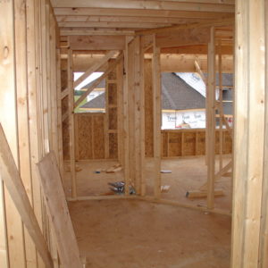

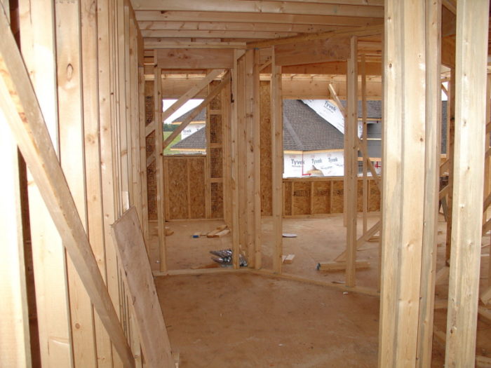

    1. technoz1 | Dec 12, 2005 07:54am | #22
      Here is a pic of the RO

        Matt | Dec 12, 2005 03:44pm | #24
        I was wondering about the ceiling height... Now that I see the pic I'll say that personally I think 8' doors with 9' ceilings are a little out of proportion.  The little linen closet doors and any small closets will look really funny.  Just my opinion, but I'd rather have 7' doors.  To me, 8' doors are for 10' ceilings.  Of course I have no idea of what look you are going for, and all this stuff is quite regional.
