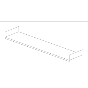

          If I read your comment correctly, you're suggesting I use the flexible flashing OR a metal pan.  The pan would be easy: bend up the ends of the "drip edge" I was already thinking of, as shown in the attached, yes?

          1. calvin | Feb 06, 2012 05:50pm | #6
            Yes, sort of........
            That is a pan missing the back edge.
            The idea is that no water gets to either side of the opening frame and cannot get inside to do damage under your finished flloor.  This while being able to drain to the outside (which doesn't have to be a continuous opening-)
            So, in most cases, the flexi flashing can be formed to produce a 3 sided pan, while also sealing the perimeter of the opening.  Some will lay this over a pc. of beveled siding (or other beveled flat goods) so there is actually fall to the exterior.  This might play havoc (not too much to deal with )  with the threshold.

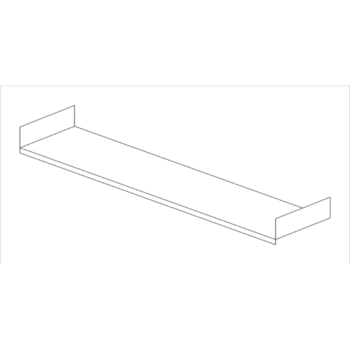

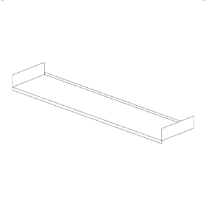

          2. WAwebfoot | Feb 06, 2012 09:35pm | #7
            Something more like this?
            The back, as drawn, is 3/4 inch high.  Those back corners could be soldered.  The length of the pan should be just enough shorter than the RO width that I can slide it into place snugly?
              I have two conditions:
            A:  South door.  At 3/4 inch high, the back of the pan will be as tall as the flooring.  My initial aesthetic reaction is that I don't want to see that metal edge between the floor and the threshold.  It would be easy enough to shorten it ( say, an eighth? ) or let it into the back of the threshold ( or both? ).  Thus butting the flooring up to the back of the threshold would cover the pan visually from inside the house.  Am I on the right track here?  Or, being too picky?
            B: North door.  The "sub-floor" is the "finish floor": a big chunk of concrete.   We have exposed aggregate in the entry way.  The area where the threshold will go had a mud sill when we poured - that is gone now.  This being the "main entrance", I'm even less inclined to want to see the back of that pan.  Would burying the pan back in a kerf in the bottom of the threshold make sense?  Or would that cause more problems than it solves?
            Shouldn't be to  bad if I plan for it: bevel the bottom of the threshold at the same slope as the siding?  Wouldn't think I'd want much of a slope.  Three to five degrees?
          3. davidmeiland | Feb 06, 2012 10:21pm | #8
            Thick walls
            I think what you might explore is using a typical Pemko residential threshold in conjunction with one of their flat commercial thresholds, which are available in wide widths. Lay the commercial down first, possibly shimmed to a slight slope, and the residential on top of it. That way you have a consistent metal finish the whole way.
            Installing a pan with a back-dam under a threshold requires some planning and ingenuity. Sometimes you can hide the back-dam under the threshold, sometimes you can rabbet the flooring to conceal it. I get pans made by a sheet metal shop to my specs. You can use a 1/2" back-dam in my opinion. The expectation is that a bit of water will leak throught the joint between the jamb legs and the threshold, but not a flood. If the subfloor is wood, this is a way to protect it. In my opinion your house should be designed to include large overhangs at doors where possible. Wood doors need a lot of maintenance if they get rained on all the time. Better to cover them so they only get wet if the wind is blowing hard.
          4. calvin | Feb 06, 2012 10:29pm | #9
            WA
            Yes, slide it in..........or what is usually done-Put in Place, run a peel and stick flashing up each leg of the opening, over the lip of the pan.  Set the door frame upon it.
            As far as A and B.-sure, you don't want to look at that thing-hold just below flooring ht.  Let into the thresh might work I guess.
            The slope?  3-5 would be plenty.
            Seal the snot out of the threshold, the bottom particularly as it may see moisture if it gets through your exterior covering.  Most store bought jambs come with a metal threshold, no chance of it taking on moisture. Remember to leave a way out for any water that gets in.
