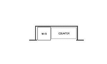

The latest wrinkle in my addition planning calls for moving the laundry to the 2nd floor hallway — in a closet. A separate laundry room got squeezed out.
I have about 8 ft to work with and my idea is to go with stacked W/D to one side, with a 5+ ft. counter for folding etc. to the side.
Ideally, when doing laundry, it would be best to have the full 8 Ft. opening open at the same time. But 4 ft doors, even bi-fold seem like a bit much. Any bright ideas?
