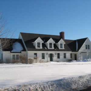

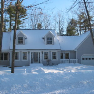

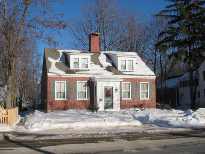

    hammer1 | Apr 27, 2008 06:16am | #2

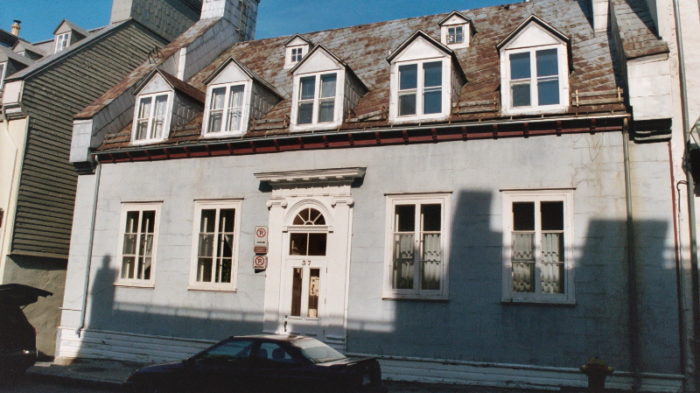

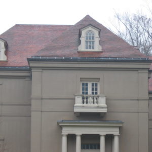

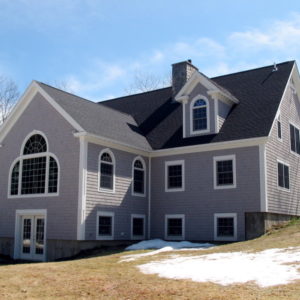

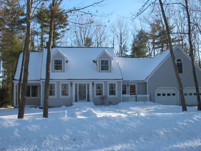

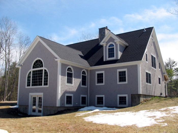

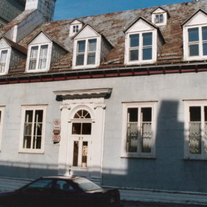

    A place to start is choosing the windows. You have to have the necessary framing around the window and room for abutting framing corners. This is the minimum. You also have to look at how you handle exterior trim and siding. Not much sense in having corner boards that only allow 1" pieces of siding between them and the window trim. If shutters are used, you need room for those.
    It's not the best idea to have the roof come up too close to the window sill. Snow build up and rain splash shorten the life. On 12/12 capes, I normally come in 2', there is typically a knee wall at 4'. In most cases, we keep the ceiling level from the room. Figure in the size of the header and choose a window height that will keep the sill above the roof junction 6" or more. If these are your only windows for means of egress, you need to figure the height off the floor accordingly. This may mean moving the dormer out a little more.
    Doing scale drawings is the best way to envision how the dormer will look in terms of proportions. The worst looking ones are often to narrow and tall. It's best to match the window in the same width as the ones below. They don't have to match in parallel, Sometimes they are balanced with the roof. Smaller windows can work but larger ones look top heavy. There are exceptions, like on a larger central dormer. Proportion does make a difference to my eye but that depends on the architectural style.
    Here are some pictures. You can decide on which ones are successful. Some look like they belong on a different building, some are top heavy, others don't follow anything I've said but still look OK.
