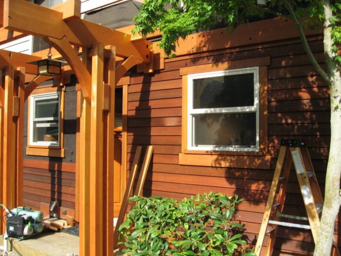

(For your reading enjoyment, here’s a picture of my project.)

    If you did the timber work shown in the pic, you can call yourself "not a pro" or, whatever else you want!

    Your work is very nice eventhough you are not a pro.  If you are not using the tools all day everyday to make a living I respectfully request you take a look at the ryobi cordless tools.  FHB did a comparo and said they were the best for the money and almost as good as DeWalts tools for half the price.

    Great looking work, If I was you I would treat myself to a new tool in honor of it.

    Nice work, you would make few pros blush.

      Thanks very much, Guys. Your comments are very helpful.I'm glad you like my project. I am treating myself to the tools I want right now 1) because I'm about 15 years from retirement and now is when I can afford them, 2) because now is when I'm working on the project of my lifetime and I need the tools, and 3) because I can justify the cost in the savings in labor by doing it myself.I'll look at the Ryobi tools -- thanks for that suggestion. But I'm very impressed with the technology and the ergonomics in Makita. I'll make my decision based on what I like best, not what is cheapest. My intent is that I'll never be replacing the tools I am buying now. ...we'll see.I have been thinking about the all-in-one BTP 140 if I go with an impact driver. But I always seem to need two tools, one to drill and one to drive, so I'm also leaning toward the BDF 451 driver-drill. Its little brother, the BDF 452 HW, feels really nice and eliminates the front end weight of the BHP 451 with hammer. I don't think the BTP 140 alone would do the job because it doesn't have an adjustable chuck. (Unfortunately (or fortunately, depending on how you look at it), the BDF 452 HW charger blew up the minute I plugged it in so I had to take the tool back.)Great feedback about driving SS. I had to drive every screw in my deck myself because I couldn't find a helper who could reliably avoid twisting off the screws or mucking up the heads. It sounds like with an impact-driver, the learning curve isn't as steep.Here's a picture of the other side of the house with another portico taken a few weeks ago before finishing the first floor siding.P.S. The BTP 140 has a clutch for controlling screw torque. I never use them, preferring to work from the feel of the handle, but it might be a nice feature if it works in impact driver mode.

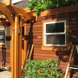

        can ya help with the pics..Life is not a journey to the grave with the intention of arriving safely in a pretty and well preserved body, but rather to skid in broadside, thoroughly used up, totally worn out, and loudly proclaiming<!----><!----><!---->
        1. MikeHennessy | Jun 07, 2007 04:56am | #10
          Here's a resize. Nice design.
          Now, to address your original question: Drills are for making holes. Impact drivers are for driving screws. Period. You'll find you mung up heads far less with an i.d. You can drive screws right through the workpiece no problem. You have to learn to watch the screw and stop when it's deep enough, 'cause the i.d. won't even slow down as the head sinks well below the surface. Try one, and you won't go back.
