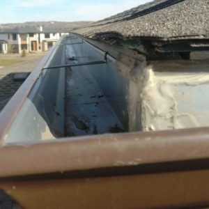

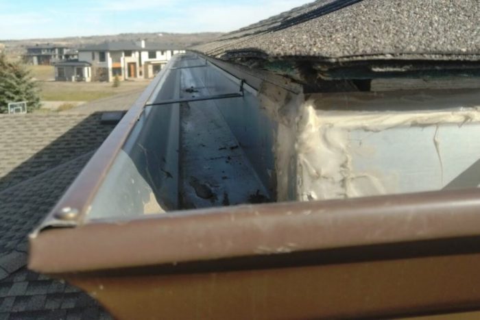

What are the codes for roof drip edge?. After removing hornets nest from gutter the only thing I see holding drip edge is what appears to be some kind of paper with adhesive strip holding it down.  I don’t see any nails . I can basically fold up the drip edge like a flap and look at the roof sheathing.  Is it supposed to be nailed or is there some new product that eliminates the need for nails. What am I missing here.

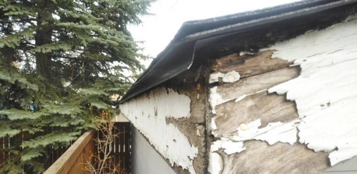

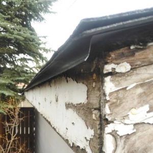

    Pulled these pics off the Internet. If this is the typical shingle overhang on homes in the U.S, of course you're going to get rot and you definitively need a drip edge. This, in no way, looks like the shingling overhang on my home or any other in Ontario.
    1. florida | Jun 24, 2021 02:54pm | #15
      That looks like another DIY job to me, it's certainly not typical of US roofing practices. It's got some sort of metal above the fascia but it isn't drip edge, it's the wrong stuff, and it doesn't turn up the eves. You can also see several older layers of shingles under the "new" roof. Very poor work anywhere. However, most places in the US require drip edge which works very well. I agree water doesn't wick up and the OP has no concerns with that. What he does need to be concerned about is the wind lifting the edge of his unsecured roof. I posted the revelant codes in #6.
