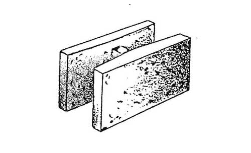

I read a few people mention surface bonding cmu block walls, but didn’t take it serious until I did some research.
Seems 50 years ago surface bonding was introduced, but the marketing somehow killed it.  Maybe masons felt threatened and that SBC may eliminate jobs.  Regardless, I’d like to consider it in this discussion because it could be used for a high performance wall system and it’s DIY..
If you were to use speed blocks, double open end bond beam H blocks and rebar throughout, the concrete grout poured inside the CMU would form a wall very close to the performance and strength of a ICF wall, but at half the cost. No insulation yet, but why would you want foam inside, insulating you from the expensive thermal mass anyway?  Foam also shrinks and bugs love tunneling in it to name a few more cons.
Has anyone installed this type of wall and installed insulation on the outside? Thoughts?
It looks like a good choice for a DIY person with time on their hands, as labor is always more than half the cost of a home.
Thanks!
