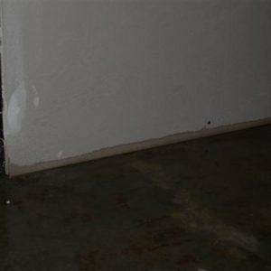

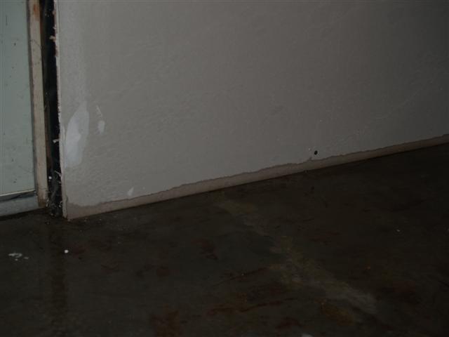

We just had our garage drywalled last week. Tonight when I went out to start getting it prepped for painting I realized that I’d forgotten to tell the drywallers to keep the drywall up off the ground.
The garage floor gets wet when it rains really hard (as it just did this weekend). Probably because of no vapour barrier under the slab, and the downspouts dumping the water too close to the house. Even after correcting the downspouts I’m sure the floor will still get wet occasionally, so I need to cut out the bottom inch of drywall.
What’s the best way to do this and have a relatively clean looking edge? I’m thinking a Rotozip though I’m not sure if it will allow me to get close enough to the ground.
Or should I try it with my sawzall or just a utility knife? I’d like to get a relatively clean edge and just leave it, but if I can’t do that then I’ll cover it with some scrap baseboard later (keeping the baseboard off the ground).

    JDRHI | Oct 30, 2007 03:02pm | #23
    Can't always tell from pictures, but that doesn't appear to be MR drywall.
    Not that MR drywall should touch the damp floor of a grage floor either, but I'm envisioning mold issues in your future.
