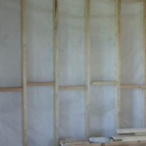

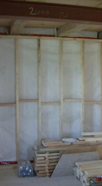

I am looking for some tips, tricks, advice, cautions,…. for my upcoming task of installing drywall on my wall that need to fit around the handhewn beams that support the sencond floor of my 1850 stone home. The beams are +/- 6″ square.
Any tips on making the cuts?
Any guidance on the clearances I should allow?
Any tips on finishing around the beams?
See attached pic of the wall before the insulation was installed/
Thanks in advance.
