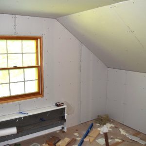

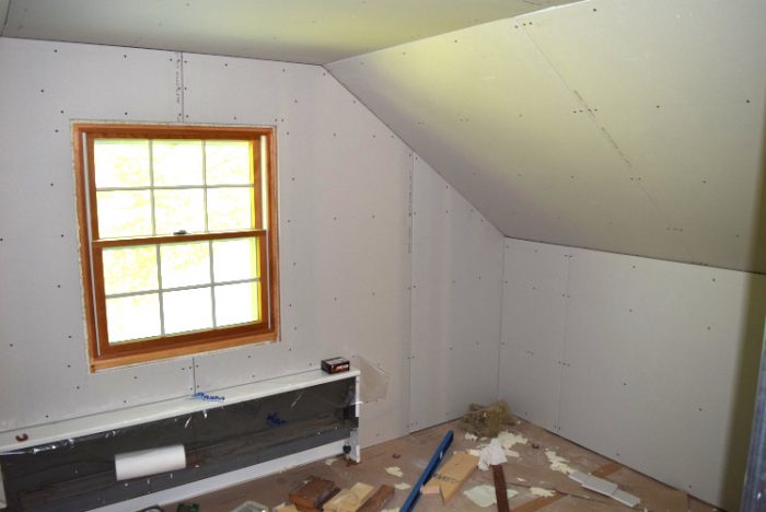

      1. nomorecoffee | May 14, 2021 08:44am | #9
        Here you go, Calvin. It all looks about the same.
        1. calvin | May 14, 2021 09:09am | #10
          SWEET!
