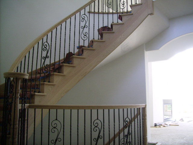

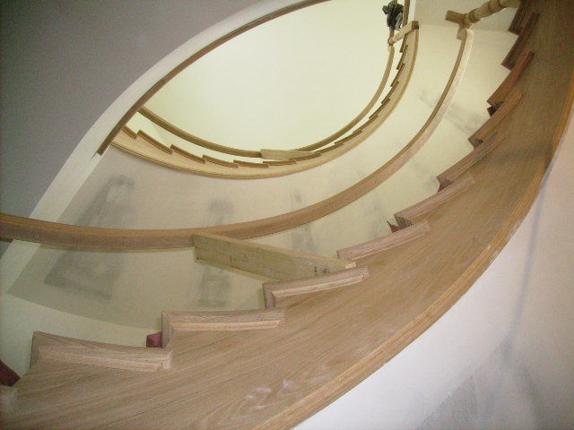

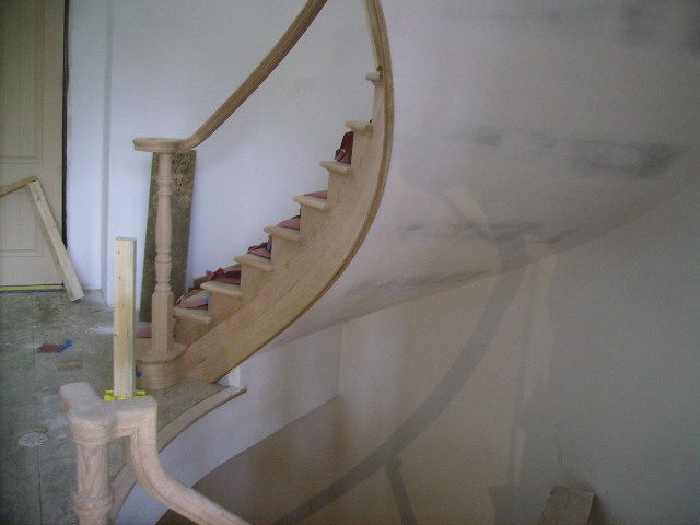

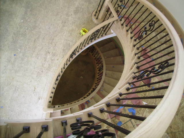

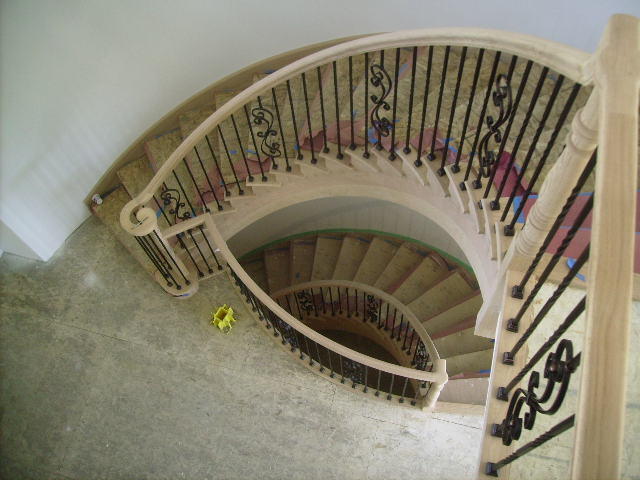

I installed this lower curved stairway Friday and the 2nd story one goes in Monday above it. It took a 4-wheel drive forklift to get it to the muddy entrance…and then 10 guys to lift and lower it into the basement hole.
By the way…I am finally on high speed internet and dont have to wait forever now to load or see pictures!
I will post the upper stairway after I get it set into place tomorrow.

For the stringers, do you outsource the resaw work for the laminations?

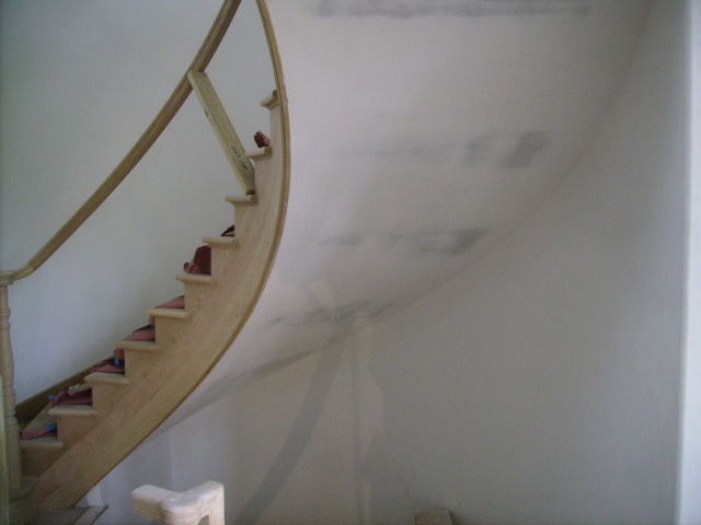

Impressive how nice the stairs fit against the existing wall. Do you frame the adjoining walls also?
Mathewson: I used to plane down 1 bys...to get my laminates...now the guy that supplies my wood....does them cheaper than I can buy the 1 bys for.
Mike: The fit is just making sure the contractor builds to my radius on the floor...and builds it vertically! The ones that are already built for me before I even measure are the tougher ones. I have to look for all the anomalies and build them into my stairforms.
What is the thickness of the plys that you use?
dovetail: Typically 5/16 inch....1/4 inch on a radius down to 40 inches or so.....3/16 inch less than 40 inches.

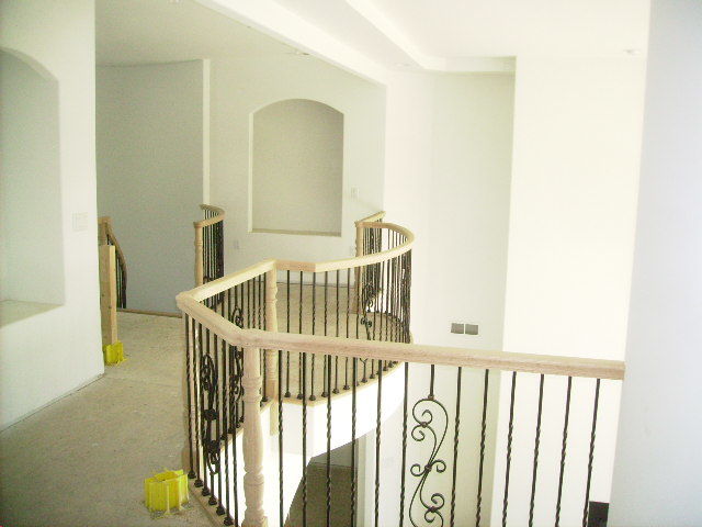

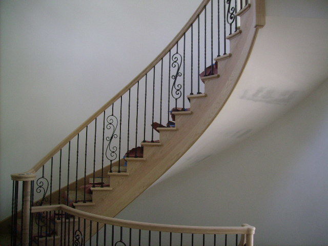

I have all the railing run except between these stacked stairways. There is a large back railing with a curved section in it that I will post pictures later.

How do you do curved railings? Stairs can be relatively easy ... it's the railing that will drive you to drink (I'll buy the gas).
I have all the railing run on these stairways and will be installing the iron balusters the next 3 days.

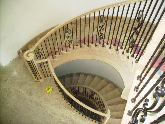

I have the 218 iron balusters installed now. The situation on this stairway is that it will be stained and finished later. The original owner lost his job and once the home sells...it will be stained to suit.

Just curious, I've installed double scroll balusters but never single. Is there anything special needed to keep them from twisting?
On a related note, do you use Goop plumbing cement, or something else?

Ted: For 1/2 inch iron balusters....I drill a 5/8 hole in the treads. I use glue...but instead of using the setscrew on the shoe to hold the baluster up...I put a 1.5 inch square drive screw along side the baluster at the bottom. The head of the screw digs in and forces the balusters shoulder into the rail...and makes it very secure against rotation as well. Its a little trick I stumbled upon by accident years ago and have been doing it ever since.
Stan, I have a stair job coming up with iron balusters and your idea will come in handy, consider it stolen!

As for the screw in the base of the baluster, does it drive up under the balluster and lift it up? That's how I'm picturing it.
I always prefer mechanical methods of attaching stuff, as you never know when you might have to take something back apart. I'd always assumed there was a better way than using glue for iron balusters, but I worked for the company and that's the way they did it. --------------------------------------------------------
Cheap Tools at MyToolbox.netSee some of my work at TedsCarpentry.com
Ted: Actually its the rim of the screw that drives the baluster upward. Picture it like this: The head of the screw is contacting just at the top of the screw since its at an angle. The screw is turning clockwise and thus the rim of the screw is pushing up as it is digging into the side of the baluster. It works slicker than calf snot.

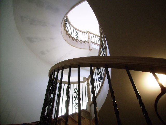

i took them out to show them the double curved stairway tonight.
