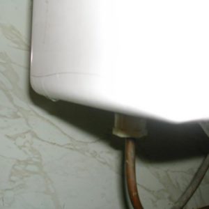

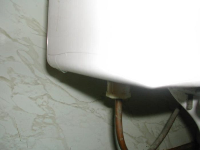

DW flushed toilet on 2nd floor, heard loud bang like a china dish being dropped and then water dripping on floor – how come??

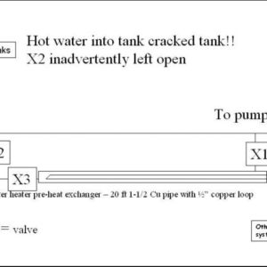

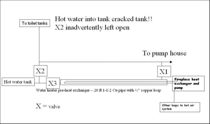

Had this system for over 30 years. (attached)
Had a big fire Friday night so had lots of hot water at about 180 F in the water heater pre-heat heat exchanger, forgot to close X2 when I did maintenance on the system summer of 2005.
Had just really stoked the fire 20 minutes before, so lots of hot pre-heat water available.
Hot water mixed with previously room temp water hot enough to cause toilet tank to crack .
Gotta pull a toilet out of a shed for replacement tomorrow, at least DW heard it right away and closed the shutoff before any leaks thru the floor.

    If that valve was left open and you had very hot water there may have been a lot of pressure at the toilet tank. When she flushed the pressure coming into the toilet tank cracked the tank. You have a lot of piping during the "normal" travel of hot water through the system which creats a pressure drop. You may even have a regulator of some sort. Not sure from the diagram. Just looking at the diagram I would feel during normal setup it wouldn't occur again.
    Look at it another way, you could open the top to the toilet and dump a pot of boiling water in the tank and I would bet it wouldn't crack the tank. I would look at the pressure doing this. You basically by-passed the system straight to the turlit.

          Definetely thermal expansion crack, no pressure.
          68F to start, warm water mix in tank when cracked at only 106F.  The tank probably was 80% or more full when crack occured.
