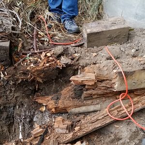

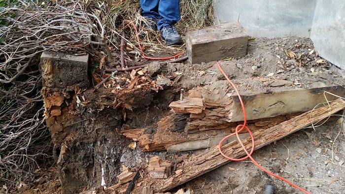

    Yes, out here in the west we must reseal all cuts. You can usually tell how deep the chemical has penetrated buy looking at the cut end. All ground contact lumber here in CA should be resealed with .9 grade sealer.
    This is what happens when you don't reseal.
    We build a lot of retaining walls with pt lumber. I've seen more rot from unsealed pt lumber that starts to rot within 2 to 3 years after install.
