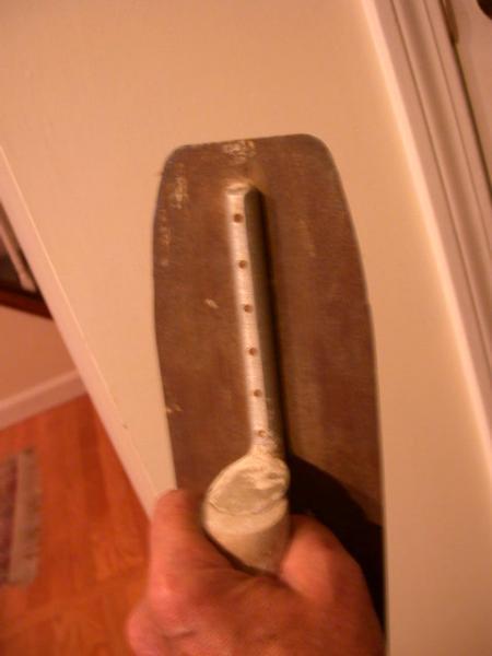

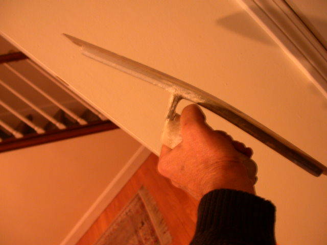

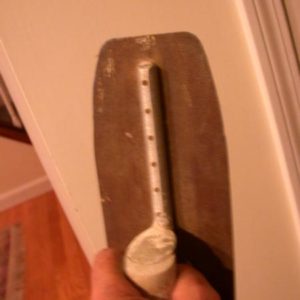

            I will take a photo of my 'bent' trowel.
            I bought it that way.
            I can't imagine bending a straight trowel with much success. And you are saying knifes.
            My 'knifes' are 6" and smaller. Rest of the work is done with trowels. See the previous post by me.
            A curved trowel's purpose is to lay or leave a coat of mud over the tape that has been imbedded with mud as a scratch or first coat.
            So, on a taper you have a paper tape tha if set correctly should be below or perhaps even with the feild or face of the rest of the board. This bent trowel if liad on a flat surface has a bend radiating out to the ends from it's center. I would say it might be a quarter of an inch, but it can vary depending on angle and pressure applied while in use.
            This trowel used correctly will cover tape on a butt or a taper with a THIN coat of compound. It covers the tape. You will likely NOT have s a smooth feathered edge on either side of the joint. You may, and this is an indication of your skill. You may not, and this may indicate a high joint, lack of skill, thick mud or a tired arm. It's time to third coat!!
            From there you need to not only apply a smooth coat on top of that coat, but further spread out the "hump" left by the coat of compund from the bent trowel. This is where the long flat trowel comes in. I have a 16" trowel for this, they make shorter and I believe longer as well. Experience will dictate your choice depending on the situation.
            By loading up this flat trowel and applying compound to both side of the joint; loading the joint then using judicious pressure and angle clean the compound from the joint. What you are left with should be a joint that is at least 30'' wide if not more. Next coat you can fill and go out even further if you like.
            I hope some of this makes sense.
            I am not a taper nor a typist.
            That's it for now!!
            EricIt's Never Too Late To Become What You Might Have Been
            [email protected]

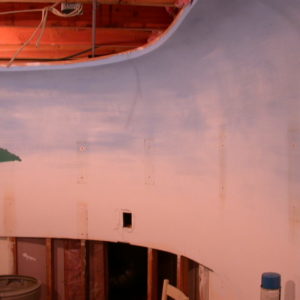

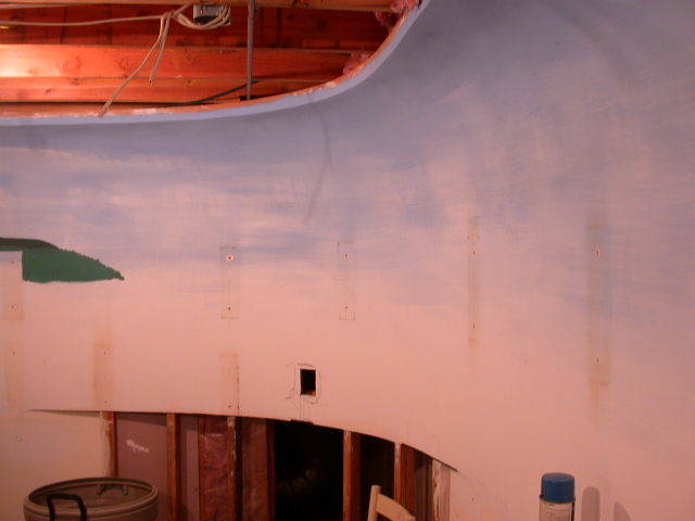

            or a room with curved walls.. like this train room  which has the corners radiused 7'  and the top of the wall meets the ceiling with a 12" radius

    EricPaulson | Nov 23, 2005 11:56pm | #29
    What kind of mud do you like to use for your top coat?
    It depends but usually regular old green bucket. What is that USG?
    I know there is another brand and I don't like it.
    Disclaimer: I am NOT a taper, although I have rocked and taped quite a few whole houses, my current drywall work is limited to remodeling, room guts and the like. I am not fast!!
    I like to set with perf. paper and compound.
    I like to second coat with Durabond 90. I have been known to mix it with scalding hot tap water. I was told it mixes up more creamy and it does seem to work and does not seem to affect the set time negatively.
    I'll do out corners to finish with Durabond, it's nice and hard.
    I'll do finish with d bond as well, depending on schedule.
    Second coat on butts and tapers always gets the 14" curved trowel. If I have edges, I might fill them fist before third coating by loading a six inch knife and smearing along the ridge 'sideways', then cut it smooth with the edge. It's a whole lot faster to get the mud on the wall this way. You may have seen tapers doing screwholes like that. The run the knife over the whole row of nails draging on compound, then smooth it off with the blade. Doing this seems to make the third coat go on nicer and I stand a better chance of having it be the last, or a least requireing less touch up or skimming.
    I do in  corners always with a 6" knife, set the paer, then coat one side at a time at least twice. I lke to use durabond for second here as well.
    Last coat or third depending on how you look at it is always with the 16' flat trowel, thinned out mud.
    The whole skimming thing I reffer to is my preference to fill small ridges and imperfections rather than sand. It's faster (for me) and way cleaner. A good knife kept clean, with well mixed and clean compound, I can swipe down to zero ridge. Keep your tools CLEAN. I use a hawk, not a box (I don't get that) and keep a sponge and a bucket of clean water handy
    If I do any sanding it's with a pole or a hand pad with 180 or 22 black paper like they use in auto body. Then it's mostly long sweeping strokes just to clean things up a bit. Never heavy localized creating piles of dust, unless there is a problem with something.
    It happens, I'm not perfect.
    One key to good taping is to start with a good rock job. And if there are gaps or what have you, take the time to fill them ALL in with setting type compound BEFORE yo start taping. It will be time weel spent. Taping compound does not fill in large voids well, shrinks and is soft even when completely dry.
    That's just about it for me so far as I can remember. I'm not much of a writer! Don't think Tauntons gonna come looking for me!
    Take care,
    Eric
    Oh! and the butt taper things; never used 'em, but I'm sur eI will, looks interesting. There have been numerous discussions here about similiar products as well as homemade deals.
