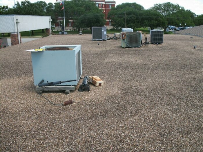

Check this photo out, it's a former church converted to courthouse & court offices (seven units on the roof-three in use; four more at ground level and a window unit).
