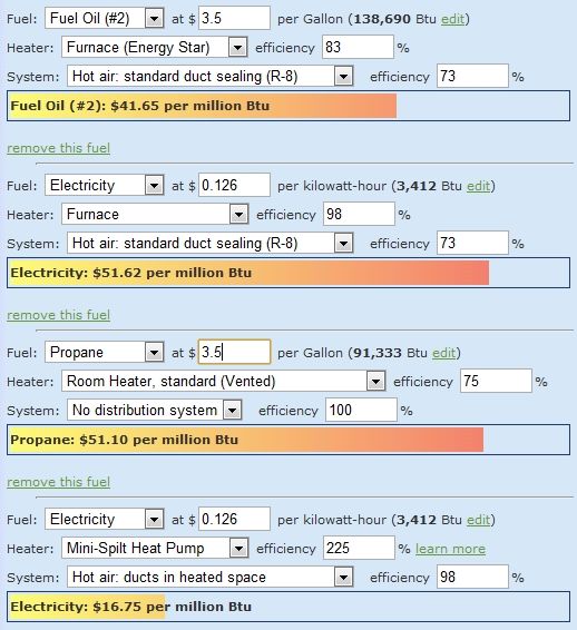

            Just for curiosity's sake, what does oil cost per gallon, and what does electric cost per kilowatthour?

            The cheapest oil prices have ranged between $3.25 and $3.60 per gallon since October.  I think when you consider the entire electric bill it may breakdown to $.126/ KWH.

            Your electric costs are fairly low, although making some assumptions about your ducts, electric duct heaters are not cheap to operate. I'd look at getting rid of oil entirely and going for a heat pump that will serve in your climate, preferably without ductwork. Out here the utility companies are really pushing mini-splits with rebates, and I can get one installed for about $3500 and then get a $1500 rebate. We have cheap electricity and expensive oil and propane so it's a no-brainer.

        It is my understanding that in my area an electric heat pump running at a COP of 2.5 (which it can down to about 25 degrees) is as cost effective as Natural Gas.  Therefore, if you do not have NG then operating an electric heat pump down to a COP of 2 or even 1.5 still makes sense over Electric resistence heat.   And a heat pump can operate at 1.5 at down to zero degrees.  If this is all true for NG and if oil is more expensive than NG, then an electric heat pump seems like an answer.
        When people say a heat pump does not make sense below 30 degrees it is becuase they are comparing it to NG forced air.  But if you CAN NOT GET NG then it is a totally different ball game.
