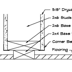

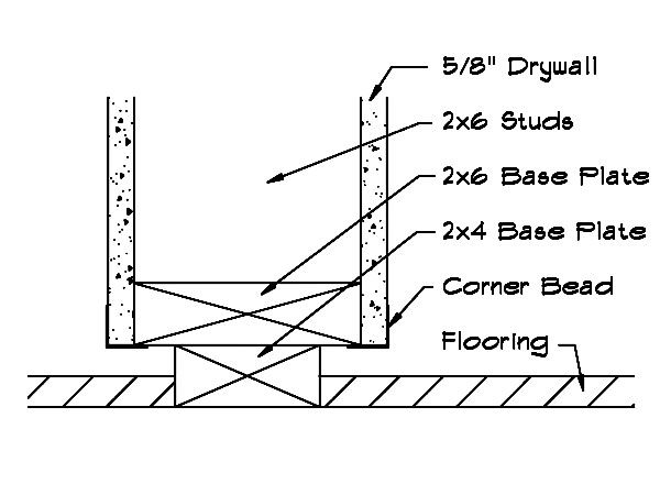

We are trying to convince our contractor and architect that we have seen many photographs in upscale magazines (metropolitan home, fine homebuilding, etc.) where homeowners had walls tied directly into the floor without the use of baseboard.  We really like the look as our taste run to the modern and minimalistic lines.  We want to get rid of trim, thresholds, etc. wherever possible.  A simple plane with no indentations, no baseboard, just flat wall surface all the way to the floor.  Our professionals have insisted that this is an unwise practice as the soft wall board will not wear well to the bumps of toys, vacume cleaners, etc.
The best solution anyone can come up with is to mount the wall board flush on top of a piece of hardwood which could be stained a different color or painted to match the wall. Even then, they say a crack will develop and it would be best to recess a channel between the two,  filling the channel with a material of a different color.  Perhaps that is the best we can do.  They have no solution for a straight, flush, floor to ceiling surface.
Are the people in the magazine photo’s crazy — simply willing to put up with a very vulnerable surface for the sake of their aesthetic tastes, or is it possible to have this look and have a durable protective surface down where the wall gets abuse?
We sure would like to know.

  1. MisterT | Oct 31, 2003 04:02am | #1
    Put a strip of  Cement board down there 6-8" wide(tall) and skimcoat  over it with easy sand.

    Have the framers install blocking (2x8 or 2x10) in the stud bays at the base of the wall.  The drywall could still ding, however with the solid blocking behind it will be far stronger.  It's alot of blocking, and somewhat labor intensive (unskilled labor though) but if it gets you the look you want, than it will be worth it.

  4. BANDAID | Oct 31, 2003 05:37am | #7
    use a double plate on bottom of walls.  It will give added support and still protect the edge.  The blocking and cement board both good suggestions.  If the wall gets normal abuse at bottom edge it will scuff no matter if it is cement board or rock.  still have to repair.  I would save some money and bypass the hardboard.
    Also I would cut off the tapered edge of the rock as it tends to telegraph through at terminations w/out seams.  At any rate it takes more work to finish and the double plates should afford adequate support.

    GoldenWreckedAngle | Nov 01, 2003 01:39am | #26
    If you go with no base use 5/8" rock on the walls. It will take the abuse a little better than 1/2".
    Another way to get the ultra clean and contemporary look your after is to create a recess at the base of the wall that causes the wall to visually "float" just above the floor. At it's simplest the recess is created by framing with a 2x4 base plate overlaid with a second 2x6 base plate and studs. Paint the recess flat black. (see attached drawing)
    When the flooring disappears into this recess the resulting floor to wall transition is really quite stunning in the right house. For the ultimate in clean and cool, repeat the transition at the wall to ceiling juncture too. Viola - anti crown and base molding at its finest!
    Kevin Halliburton

    2. djbeers | Nov 01, 2003 02:32pm | #35
      Wow.  This is a very creative idea and takes our thoughts to another level.  I will share this with our architect and builder.  Because the wall board is still only 1" above the floor and even though its edge is protected with a corner bead, I think it may still make sense to use a cement board or other hard coat surface.
      Again, Wow.  You (and most of the other guys and gal's ) are really, really, on top of your game.
      Dave and Barb
    3. hasbeen | Nov 02, 2003 05:16am | #42
      Sounds like a house cleaning nightmare, Kevin!  I guess the dust bunnies just fade into the flat black paint?Any jackass can kick down a barn, but it takes a carpenter to build one.
        GoldenWreckedAngle | Nov 02, 2003 11:14pm | #46
        I'm not suggesting this is the ultimate solution, I'm suggesting that it is a good solution for this client with their stated goals. As to the dust, it would take the same amount of time to run this recessed base with a vacuum nozzle as it would take to run the top of a protruding base where the dust accumulates in a standard house. There should actually be less dust in the recess since it has an overhang preventing dust from settling in the recessed area in the first place.
        Seriously folks, look around your room at all the small, horizontal recessed spaces that surround you. It's not a problem. Pick up a modern architecture magazine and flip through the pages. It is almost certain that at least one of the featured houses will have this floating wall, no base detail.
        Sure it's different - lot's of things about modern architecture are "different." It works and some folks appear to really like it. I just gave a means to easily execute it.
        Now the top of a refrigerator and all those ceiling fan blades 12 feet off the floor... there's a maintenance nightmare! :-)>Kevin Halliburton
