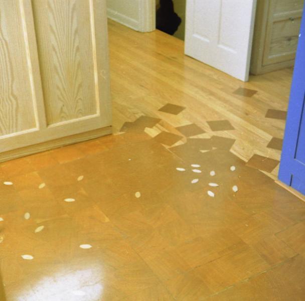

Been talking about this floor ever since I started reading/posting here at Breaktime. Today I finally took some photos.
The scattered leaf inlays on the left conceal screws needed to fasten the floor back down to the sub-subfloor after seasonal humidity changes swelled the endgrain blocks and lifted about a 2 foot bubble a couple years ago.
The more tightly scattered leaves on the right I put in last week when another section did a similar lift.
Now before you get on my case, I tried for all I was worth to get her to let me install these blocks with some cork spacer grout to absorb the inevitable seasonal movement. No dice. She wanted what she wanted, and she wanted it right then. I did my best, crossed my fingers and hoped.
Have to say, though, I do like the way it looks when the inlays are sanded flush, joints are filled and everything is oiled.

There are "leaves" there. pi. Here's a shot from the other room. See the scattered small light colored areas? Those are maple leaves inlaid in the fir blocks. The ones to the left, the slightly darker ones, have been sanded flysh and oiled...a couple years ago. The ones to the right, more tightly clustered, and just slightly proud of the floor surface (like maybe 1/100th"). They haven't been sanded flush yet.
Well, learned something new today!! I like it......
What are those big white splotches in the "sink side" pic? And in the "pantry side" pic ... it looks like some of the blocks have been scattered to blur the demarcation line between the two floors ... is that right? I like the look.

Yeah, on the pantry side she wanted it to look as if someone had dropped a bunch of blocks and they scattered. So right at the edge, they are all overlapped and intertwined. As you look farther into the oak field, you'll see they are more scattered. Took her and I the better part of an afternoon to lay that section out. That was a six Tylenol day.
Later, when we had to refasten the floor somehow, it seemed only natural to atick with that same theme. I went outside, found a common leaf, and used it as a template to make a jig to inlay leaves in a "scattered" manner to conceal screws we needed to fasten down that area.
