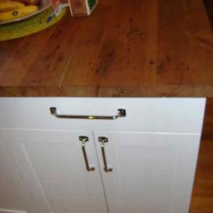

    1. gfretwell | Jul 14, 2009 08:04pm | #11
      Why do you think poly is so fragile?
      We use the hell out of our countertop (it is also the catch all for things destined for the garage) and I have not noticed any heat damage or water staining. I had one section under a coffee maker that was wet most of the time for years. A quick wipe and it was fine.
      I don't put hot skillets on the counter but pans with boiling water won't hurt it. A 400 degree skillet will hurt any of them. We do try to use a trivet under pans but you know how that goes with kids around. As far as I can tell it seems as tough as laminates and solid surfaces like Corian.
      I also like the idea that knocking over a glass will not result in breaking it, the problem with stone products.
      Worst case and I do hurt the counter, fixing it is easier/cheaper than any other product and so is replacing it.
      I started out very skeptical, this was my wife's idea, but experience has made me a believer.

    2. gfretwell | Jul 14, 2009 08:16pm | #12
      This is the top right nowhttp://gfretwell.com/ftp/counter.jpg
      1. Scott | Jul 14, 2009 08:55pm | #13
        Hahaha.... I like how you tossed the hammer and cutters in for effect!Thanks all, much food for thought.Scott.
        1. gfretwell | Jul 15, 2009 05:53am | #16
          Actually I put them there because I had them in my car and they were on the way to the garage. Needless to say there has never been a car in my garage.
