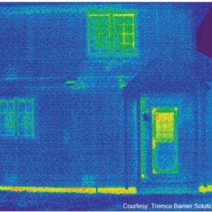

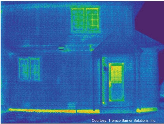

    jonblakemore | May 06, 2009 06:34pm | #20
    As others have said, there are places to insulate where you investment would be more efficacious.
    However, you may still want to consider the insulation on the slab perimeter. You don't have the same Delta-T as a house in Northern Montana, but a house that is otherwise well insulated will leak from the exposed area you have.View Image

      Good point and Thanks for the photo! Those cameras are hard to come by. Many of us would not spring for the cost of the photos.
