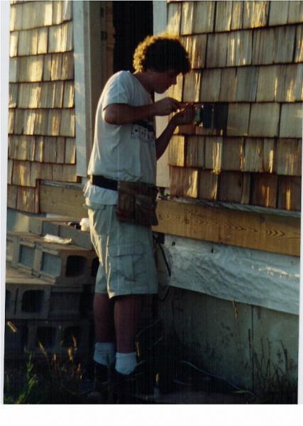

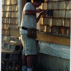

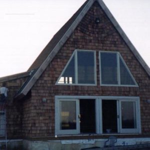

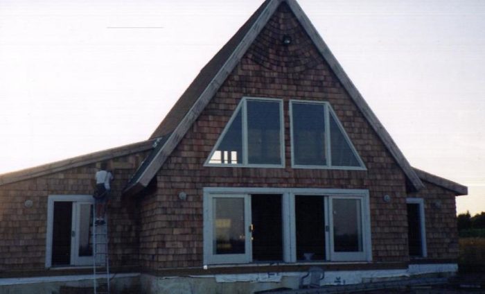

  3. booch | Jul 22, 2005 11:07pm | #9
    I did that but with 35 square worth of the split shakes. I'm digging out the pictures from my hard drive for your review.
    It is way more labor intensive than I thought possible. I shortened the project by making a 10 foot jig out of a 1 by 8 and a firing strip nailed to the bottom of the 1x8 Then I added  2 cheap levels that I positioned with screws then glued with polyurethane adhesive. I actually made 2 jig boards. 1 - 10'er and the other 6 foot long for tight areas. The firing strip hooks under the previous row's bottom, then I level it with the levels, then I use a nail on each end of the 1x8 to hold the jig in the leveled position. At this point you set the shakes on top of the pine board and nail each in place after you get a good looking fit of the shakes.
    Meshing it with Soffit boards was really time consuming. It took a case of "cedar colored" silicone caulk and backer rope to fill the gaps. Of course the Gable ends were the biggest problem.
    Fitting the shakes together requires a utility knife to shave them to fit. Then of course you have the square, right lean and left lean shakes. (you'll know what I mean when you get to fitting them side by side.) It isn't just grab and nail. I borrowed a mailman's shoulder bag to carry the shakes up the ladder and provide me a quiver of shakes from which to select.
    Short answer is about 7" exposure. You want 3 layers of cedar on the wall to make sure you have visual coverage of the subsurface paper. Two photo's are attached of me from far away and my son doing wiring up close to the shakes. 10 inches is a lot of cedar to have flapping in the wind and reacting to the wet dry cycle.
    My substrate is Tyvek over 3/4 inch Foam board over nominal 1/2 inch osb on the 2x6 studwall. It holds (has for the last 3 years with frequent 50 MPH winds and subzero temps in the winter next to lake Michigan.
    Also, and this will cause a firestorm of debate, use a power nailer with galvanized RS nails. You really do not want to set these nail heads in the shake or else you make kindling in a big way. Hand nailing may work but I could control the Paslode far better than the occasional mis-whack with a hammer.  It takes some skill but you hold the Paslode or power nailer at an angle so the head is consistently in but not countersunk.
    I'll dig for a better photo of the jig. The photo of me is too far away for the picture to be visable on these photo's.
