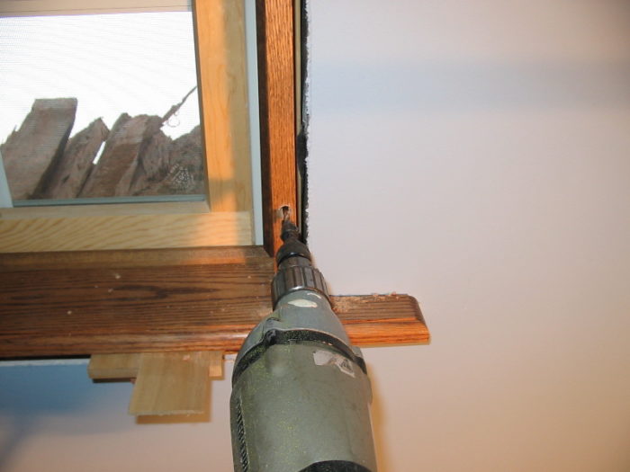

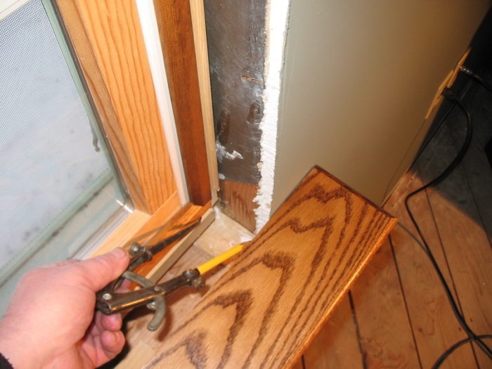

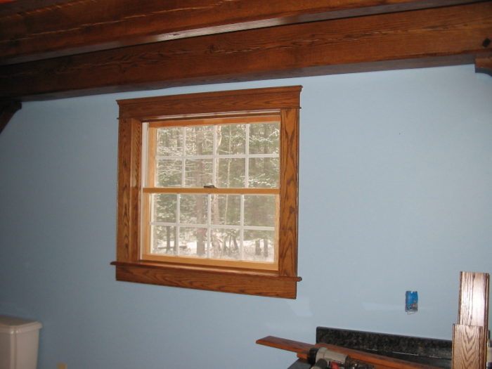

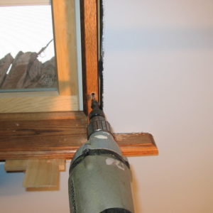

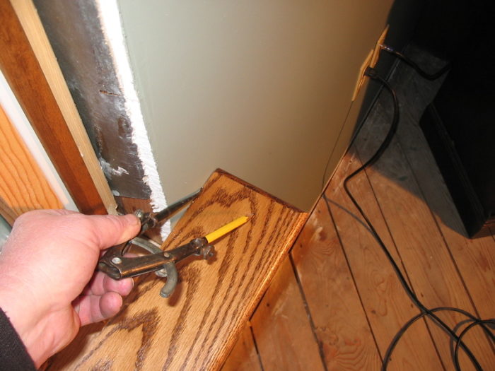

    hammer1 | Jul 21, 2005 12:53am | #13
    I just happened to take a couple of pictures of extension jambs I made for some Anderson windows. This home was trimmed in red oak, so, the jambs and sills are oak. Board sheathing was used, therefore, factory extensions would not fit. I've always found it easier to make my own, particularly if the framing wasn't nailed flush or wall thickness varies for some other reason. The Anderson factory extensions are rabbeted to fit into a groove in the window. I didn't use a rabbet on this job. I attach directly to the window so shrinkage isn't much of an issue at that junction. My process does require careful placement of the screws and a correct length. Screwing the windows shut or restricting the tilt feature isn't good. You may have to shim and face nail for extra wide extensions. For extensions wider than 3 1/2", I would recommend using a rabbet. Andersons aren't available for different thickness walls unless you want to pay and wait for custom.
    Andersons are very uniform in size. You can cut all the pieces for 20 alike windows the same, and have them fit nicely. I like to assemble the extensions on the bench and pop the whole thing in place rather than do them piece by piece. I think it speeds up the process and keeps things square. You still have to scribe in the sill for each unit, if you use a sill, and want a tight fit.
    I like to pre-finish the materials and paint the walls before trim installation, when possible. I measure all the windows and take the average for the width of the extensions. They sometimes vary 1/4" so I split the difference. Remodeling can be another story. The space between the framing and extension jambs gets insulated, of course. If the factory was able to supply the wide extensions, they would likely be finger jointed, not solid. They could be warped, too. I think you would be happier making your own.
