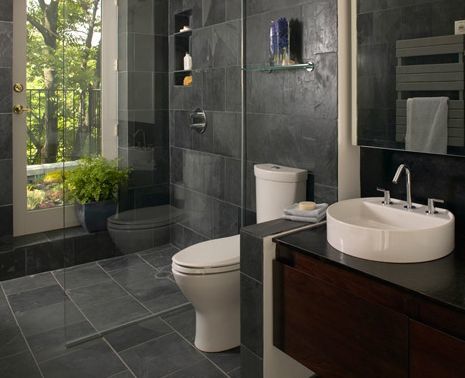

    My project is basically adding a bathroom into an existing space (slab floor, converted garage that had been previously permitted and changed to a workroom.  I'm putting the bathroom in the corner or the room which has an existing exterior door ( the one that I have to keep as a door).  This is the only space for my new bathroom and space constraints require that to be the corner with a shower (long narrow bathroom 4 feet wide).  I want to replace the door with one that can handle the moisture and open directly into a large (48x48) tiled shower area.  It's not an existing shower so I have some flexibily here and turns out I already have a fiberglass exterior door with tempered glass.
    Here is a picture I found on the internet that is similar to my 'future' bathroom.  Anyone out there that can help with how to do this .. door type, frame, how to seal, ect..
    This is a link to the picture of what I want to do (it's the 3rd one down):
    http://lifestyle-maker.blogspot.com/2010/07/innovative-aesthetic-luxury-bathrooms.html
    1. DanH | Apr 18, 2012 09:44pm | #41
      You'll notice the curb under the door, and the resulting "step down".  That's what you want, if you can possibly accomplish it.  Doesn't need to be as high as that one, but 2-3 inches at least.
