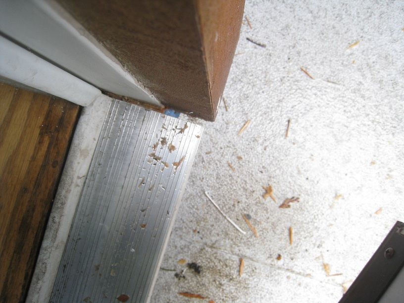

    1. calvin | Feb 27, 2012 05:46pm | #13
      bg
      You mentioned the bottom sweep on the door is good-I see there's no adjustible threshold there.  Does your sweep (along the bottom of the door edge) have several flexible "fins" and do they sweep across that threshold?
      In the picture above, there is also a gap between the jamb weatherstrip and the metal lip on that theshold.  That is where I previously mentioned we use a flexible wedge "pad" usually supplied with the door unit.  Also applied to the other side.  Can you ask at that worthless depot if they have a couple they could give you ?   They peel and stick and slip behind that jamb weatherstrip and usually sit on top of the adj. thresh.   However, in your case, I think I'd cut a notch in the pad and let it go down all the way down (part of it will sit on the top of that raised lip.
      Did you replace the jamb weatherstrip when you put that new door slab in?  Might not hurt to do that either.
      In the pic above?  What is that clear sheild above the door?  Does it tip back towards the wall?  If it was tipped the other way it might shed water-now it could direct it back to the wall and then down both sides of the door.
      And in the pic above-is that a surface applied sweep on the door?   If so, any water getting alongside the door is being kept from exiting out by it.

    The "grey thing"  I mention appears to be another flexible weatherstrip.  I mistook it for a raised aluminum part of the threshold.
    You have pulled it out a bit in this picture:
    EDIT:  Is that a gap between the painted jamb and the exterior stained "cedar"?  That's not good if it is.
    I've never seen anything like this on a threshold.  In new prehung entries there's usually a raised adjustible threshold which you can move up or down for a good fit to the bottom sweep on your door.
    Further, what you have doesn't appear to have much fall (slope to the outside) which would evacuate water easier to the outside.
    You might be able to leave what you have-install the corner pads and solve the problem-I would change out the threshold to an adjustible like on new door entry systems (see the link above-I bet they show what I"m talking about.

    Further, in this picture:
    The threshold is just sitting there bumped up against the jamb side.  This joint will allow water to get under the threshold and seep back in-under your oak floor and rot it from below.  You should clean it and dry it out completely and then caulk that joist with Urethane caulk.  Both ends of the threshold as it can't be any better on the other end.
    How am I doing with explaining it this time?

      Probably hard to tell from these pics but there is at least 2" of height under the metal threshold and the deck vinyl membrane does come up the wall so unless the water really pools then that should be fine.
      Yeah the threshold should probably have been installed under the jamb trim and not leave that giant gap there.  I am planning on caulking it, good to have the suggestion on the urethane I'd probably just have used something I had lying around.

    3. bluegoat | Mar 07, 2012 02:44am | #25
      Still thinking about those corner pads.
      This is a picture of the deck door closed from the inside.  The weatherstripping appears to get flattened against the side of the jamb rather than the front of the door stop in the bottom corner.  It appears this is partly due to the design of the door.  The inside face of the door has a reveal which provides a gap for the weatherstripping - except at the very bottom where it comes back out to match the surface and provide a better edge for the door sweep.
      Any idea if the corner pads will solve this problem or if there is some other solution?
      I did use my dremel osc tool to remove a portion of the sweep which I thought might help.  This worked well on the latch side.  I suspect that the weather stripping has just lost it's memory as the original install had it being flattened like this for month.
      The corner pad site looked quite promissing I just need to special order or find a similar product from a different company.
      1. calvin | Mar 07, 2012 06:17am | #26
        blue
        From these photo's you've posted, I'm not impressed at all on the materials or the installation.  While it allows you a smooth transition to the outside, all you have blocking the water at the bottom is a sweep on the bottom of the door (that looks like it's adjusted as high as it will go on the hinge side) and a compressible weatherstrip (that at the corners is the hardest for these to make a perfect seal).   There's little fall on the threshold that adds to the ability of water to come in.
        Here the extension thresh looks like there's little if no fall to the outside.
        The darkened grain of the wood usually means pretty good saturation.
        The wood floor shows that water has been a common problem.  Looks like more than surface damage-I'd be surprised if it isn't soaking the wood all along the butt edge as well as staying moist underneath.
        I would go to a good lumberyard, a bogus box store, anywhere that sells doors and get a pair of pads and try it.  If it works, a cheap fix.  Still, the install as I see it is marginal at best and constant monitoring will be the future.
        Best of luck.

          Here are a couple overview pictures as the others have all been detail shots.
          1. calvin | Mar 07, 2012 08:36pm | #30
            oh my.
            What would I do differently?
            I would make sure the slab that door sits on was level all the way across it's expanse.  Is it foamed or caulked under the metal threshold?  Not good.
            I would have installed in this case, a metal pan first between the framing at each side of the rough opening, weatherfit and sealed, that could capture any, water that might make it behind the door jamb/threshold.  That pan would have a lip on the backed / ends that would keep water from that oak step (all along I thought it was a floor.
            The thresh would have positive fall to the exterior.
            When you open your pic above it's HUGE.  But when you do, you can really see some detail.  How is that door casing made up?  Is it hollow, with no cap on the bottom?  Water doesn't just go down.
            I would have a bottom of the door seal pushed down to seal and allow the door to open nicely.  You want to keep water and air OUTSIDE.  The interior side of that thresh would have a lip with a small bulb weatherstrip that would compress  when the door is closed.
            (so no to the slope of the interior wood, yes to the slope down and out of that metal threshold)
            The corner pads as already mentioned.
            Frame would be made utilizing a "Frame-Saver" at the bottom portion of the jamb.  No wood, no rot.
            The perimeter trim / stucco would be installed in such a manner to keep water and air out.
            Then say a bit of a prayer-and not relying on caulk.
            Seal all the cut ends of wood.

            The outside trim (casing) is mitred cedar.  1 1/2" on the jamb side and 3" on the outside face.  It is solid and while there is a top there is no bottom.
            The aluminum threshold looks to be foamed to the blueskin.
            Is framesaver from Endura?
            http://www.enduraproducts.com/product-overview/framesaver/index.aspx
            While there is no framesaver in this case, the casing isn't touching the threshold or the decking so likely not a large chance of the framesaver issue.
            So let's assume that you did the install.
            The pan is installed and butts up against the oak step.  The aluminum threshold is put on top of the pan.  Is there still a bottom piece of weather stripping against the oak step that serves as the bottom door stop?
            Let's assume you also properly shimmed the jamb for the door but that their is still a clearance between the door and the jamb and let's assume that some water does get wind blown into the jamb area.  The water would drain down to the threshold and sit there restricted from exiting by the U shaped door sweep.  The threshold is aluminum so it won't rot and the pan is protecthing the oak step so it won't rot.  At some point though assume you aren't using the deck in the winter and the rain continues to drain into this area, either the water goes over the inside pan side or it goes over the top of the sweep attached to the door at which point the water would start to either rot the door (the fiberglass door has a bottom wood piece for the sweep to attach to), soak into the step weatherstrip or rot out the sides of the jamb (guess you are protected via the framesaver).  Even without rot from the water surely this area would mold or misdue.
            Is that how you think it would work or am I missing something?
            Thanks again,
            MG
