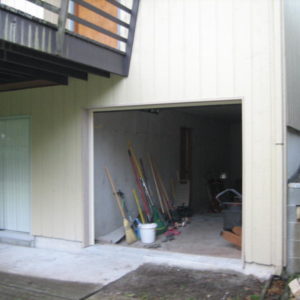

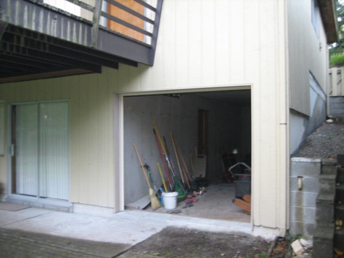

I am curious to hear how people have wired their exterior lighting over a garage door. I do not want to put a flood light above it. I am looking at more attractive options for low level safety lighting like a jelly jar or something similar centered over the door. The problem is, I can’t flush mount a box because the header is there. I can’t flush mount boxes on the sides either because of the jack and king studs. The round exterior boxes with the screw in plugs are 4 1/2″ round. And most lights that are not flood lights have 5 1/2″ bases or larger, so it doesn’t seem like a good fit. Does anyone have experience with this issue? Are there larger diameter exterior boxes out there? I am considering just rewiring the light with longer leads so I can make the connection behind the wall at a junction box there. Any problems with this? The interior is all concrete, so my wiring is surface mounted EMT. Any tricks with 1/2″ EMT that might solve this issue? Thanks.

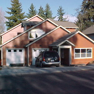

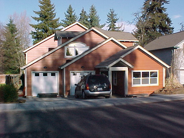

    I'm attaching a pic ... it's not a closeup, though ... couldn't find one. I mounted above the header ... probably ON the header.

    You're blessed if you have solid concrete - though your comment about a header make me wonder. In any event, the idea is to mount a box on the inside wall, directly behind the light. Make the run through the wall using something called 'running thread,' also available from the supply house. You'll also need two lock nuts and a bushing on each end of the running thread.
    Another thought is to completely conceal the fixture between the joists of that deck; doing so will let the light shine on the drive, yet not shine in your eyes or mar the appearance.
